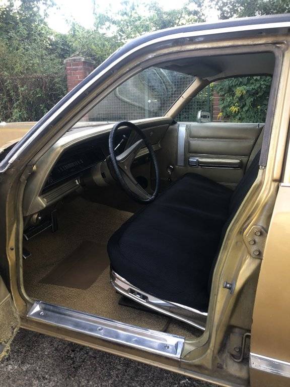

Hello from germany,
Fall is coming, and it’s been raining very bad lately, I had to discover that the water comes through my cracked, porous, hard weatherstripping. Does anybody know where I can get a full set of weatherstripping (door seals and trunk seal) for my Newport? I don’t really care about originallity, as long as it keeps my freshly done interior dry and lasts longer than a few months :D
I don’t want to use the universal self adhesive stuff, so has anybody a better idea?

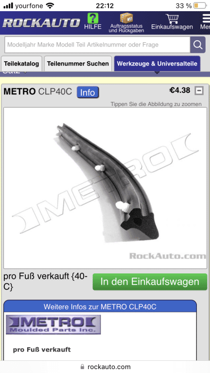

Thanks for the tip with Rockauto!
I found something that looks very familiar to the seal I have in my doors, especially with the little plastic clips in it, what do you guys think? Could be worth it to order some?

It rained so badly last week, that the water just ran in on top of the door and on the vertical section. It’s a cali car, so the whindshield and back glass are absolutely dry, it’s just that the door seals are more like ,,plastic” after 50 years, than rubber.
