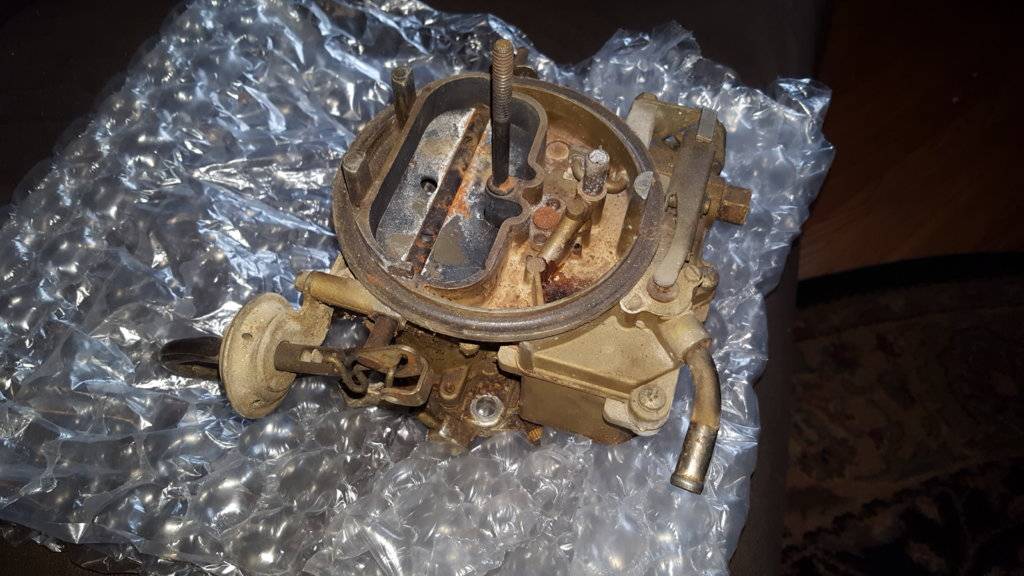

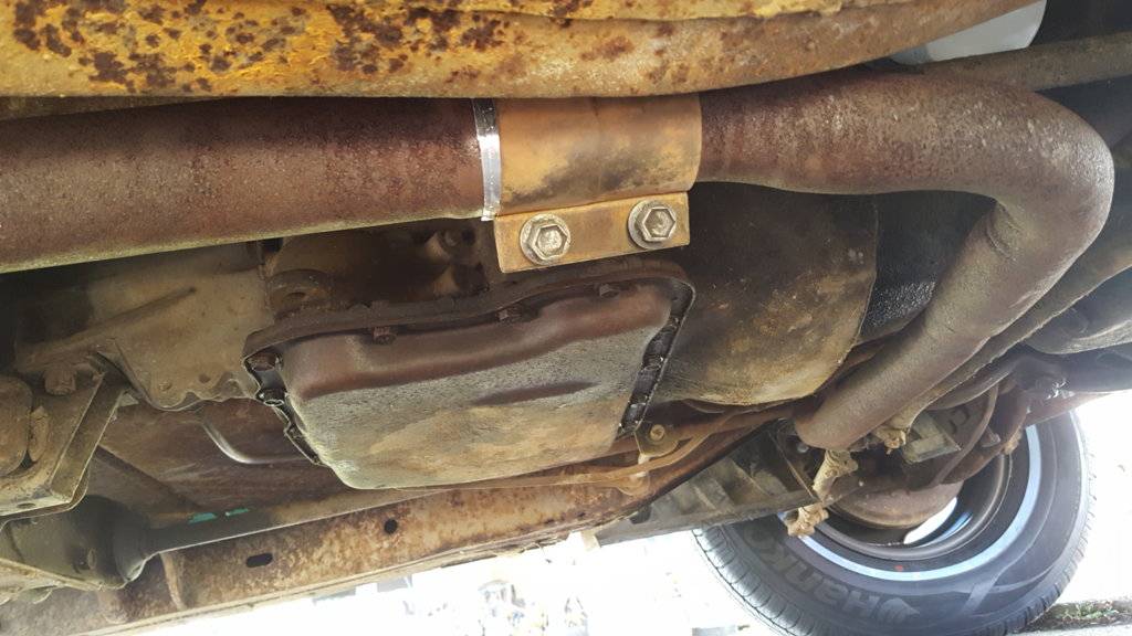

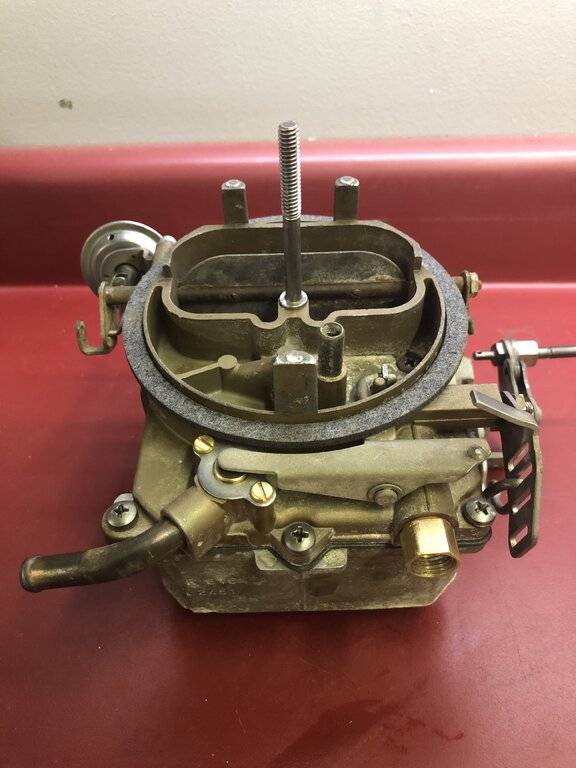

Was able to get most of the exhaust mounted up, still need to install the pipe that crosses over the axle. It sounds so much better now. And the 2bbl carb has started to give me fits so I'm currently boxing it up to send to @Dana for a rebuild.

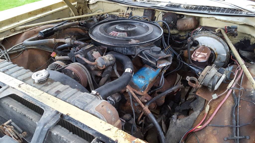

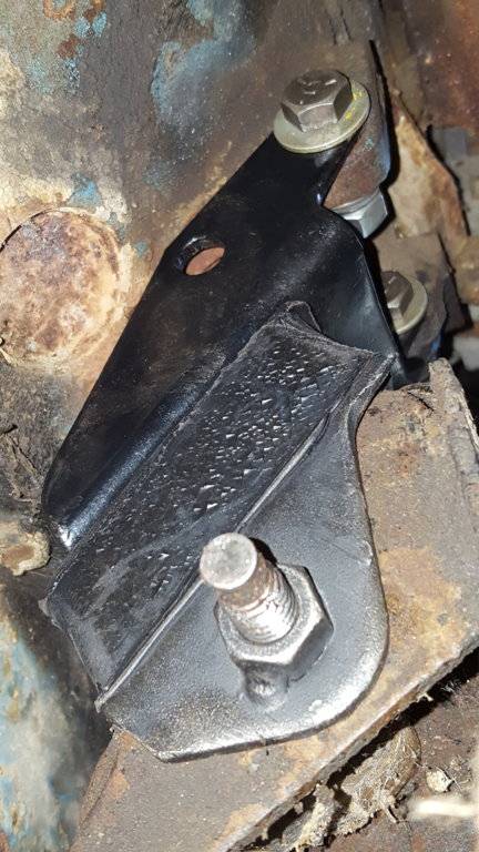

Installed motor mounts today. Went to the hardware store and replaced those darned locking nuts with regular ones and a lock washer. The engine sits much straighter...also installed the Y pipe and replaced some leaky heater hoses. Hope to get the muffler installed tomorrow and then take it out to buzz around.View attachment 368105 View attachment 368106 View attachment 368107
I will say that the stover nut (those darn locking nuts...;) ) are there for a reason, the regular nuts and lock washers you put on will be a lot more prone to vibration and eventual failure...ie: coming loose.
Wagon is coming along nicely...sweet that the parts car exhaust system was in such great shape...big score on that one!!
And love the steelies with dog dish caps...:thumbsup:

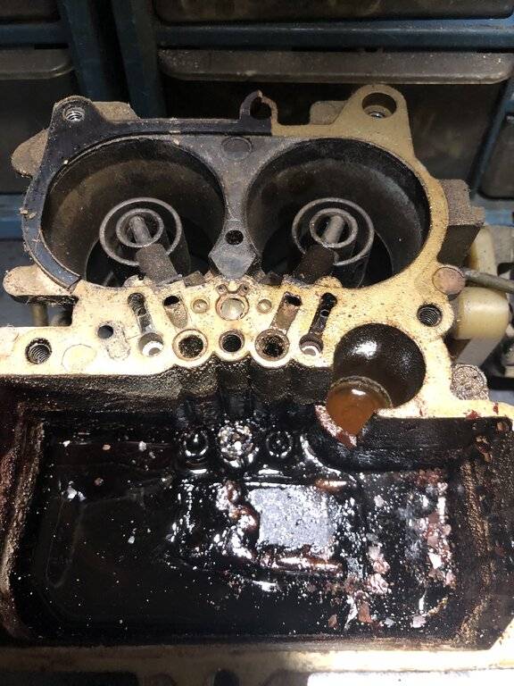

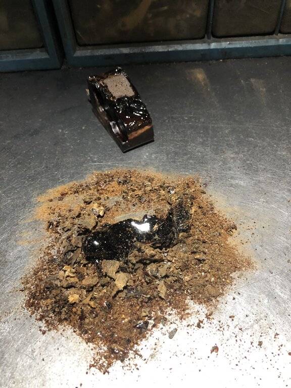

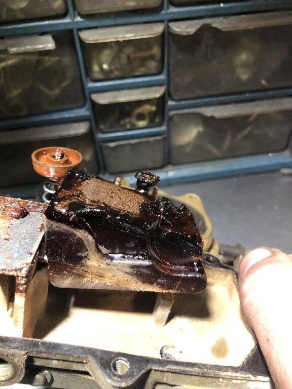

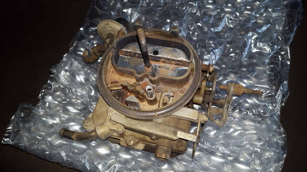

Hey Paul, she was a little on the grungy side, to say the least. I had worse in here, I just can’t remember when!
Yikes @Dana I guess there was good reason why it wouldn't run properly. I ended up sending you the original carb that was swapped out back in post #68, instead of the one currently in place that is also running poorly. Thanks, let me know how much I owe you and I'll make good tonight after work.
Ok Paul, she’s ready. Yours and sixpkrt’s carbs will ship this afternoon. This 2bbl is very responsive.
Wow, it looks great, thank you very much! I'm helping @Xenon this afternoon at his warehouse, I'll call you tonight!

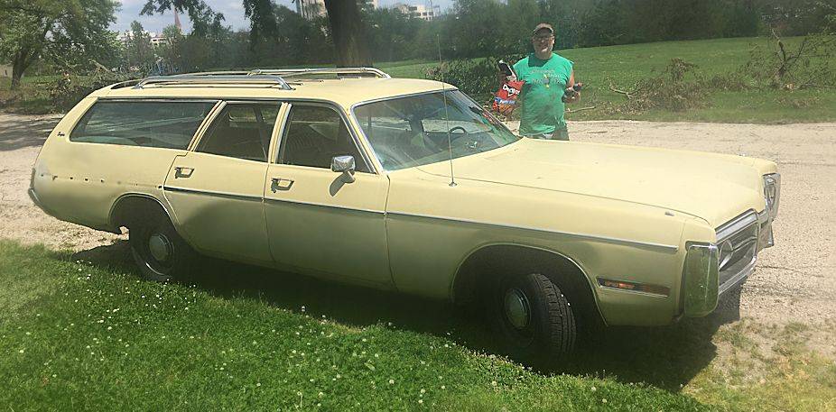

That turd made its first maiden voyage this past week
Am I the turd or are you speaking of, or the Suburban? :rofl:
This afternoon I'm solving that gas tank/fuel container situation with a trip to "Gas Tank Renu" in Bloomington to have the original tank repaired.
And unfortunately your picture is the last time that right front hubcap with be captured in a photo...the lovely Illinois potholes jarred it loose and sent it flying near the I-55 exchange along Interstate 80 :BangHead:

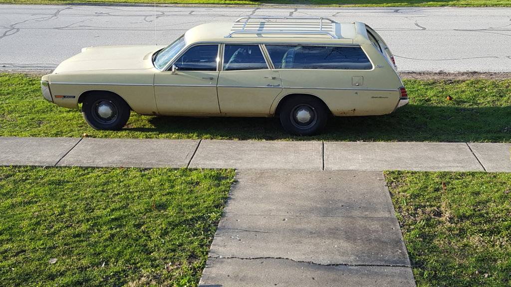

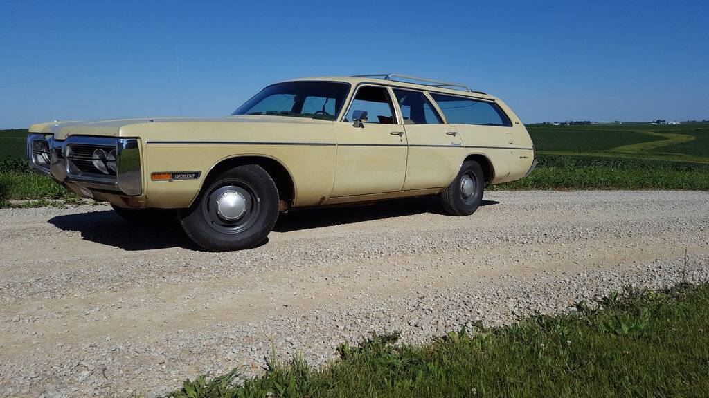

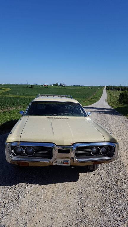

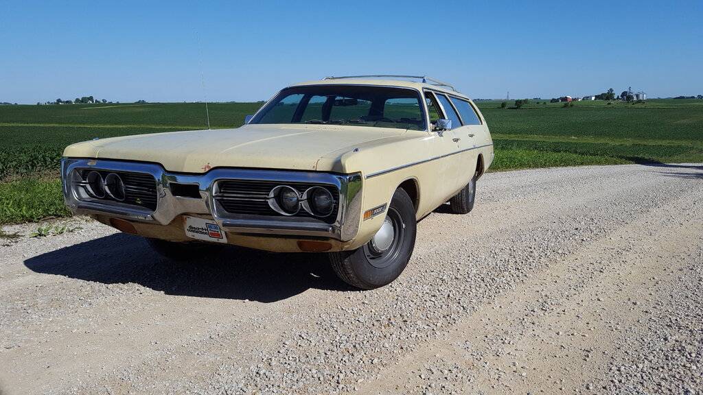

Out enjoying the beautiful weather today, drove the Plymouth to my parents place. Probably have put somewhere around 500 miles or so on it since it's rescue from a cow pasture...fun times!
Out enjoying the beautiful weather today, drove the Plymouth to my parents place. Probably have put somewhere around 500 miles or so on it since it's rescue from a cow pasture...fun times!View attachment 381888 View attachment 381889 View attachment 381890
Great pics and really great to see that old gal driving again. I had a 73 Custom Suburban...man, I'd love to have that car back now. So much fun to drive. Especially now that we can get a fair amount of parts for them and keep them running well.
Good luck with it and enjoy it!!
