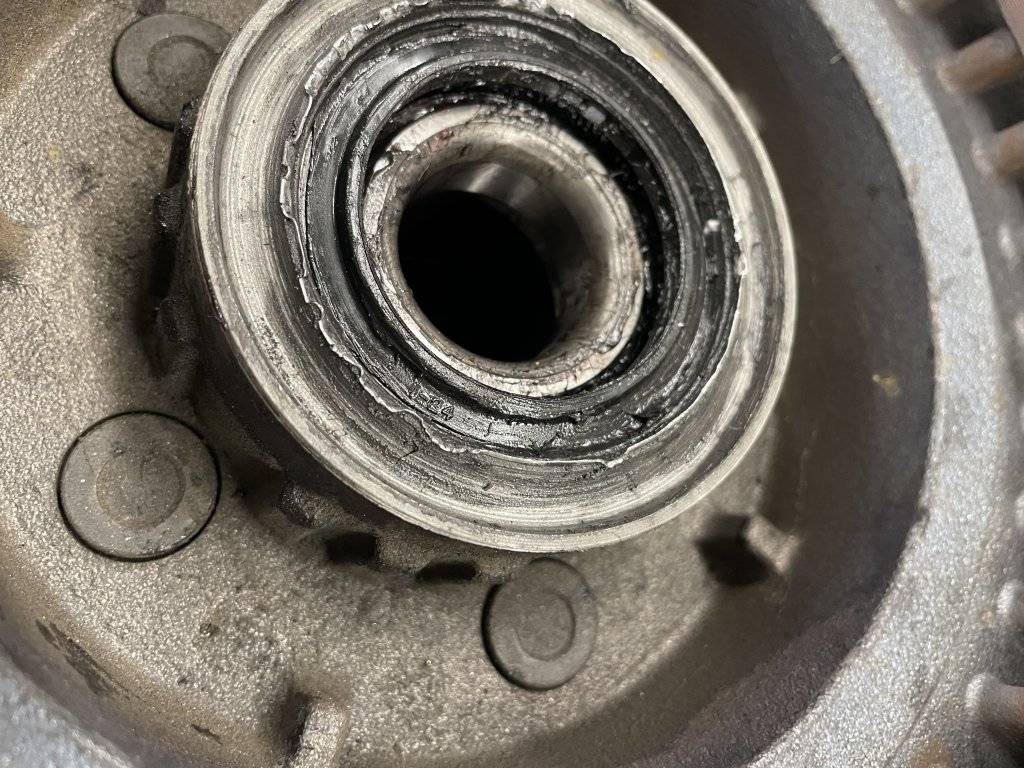

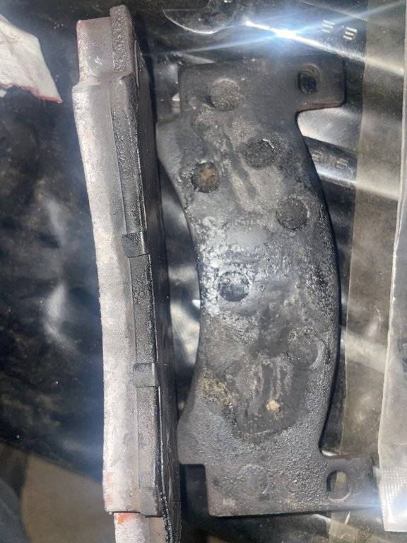

Currently falling through a rabbit hole trying to diagnose why the passenger side front brake was smoking after a drive home. At first I realized that the eBay rotors I bought were rubbing and grinding itself against the ring around the spindle so after ordering the proper ones from oreilys and installing them it still smoked up. However only the passenger side is the only one with this problem even with the eBay rotors the driver side works fine. This leads me to the caliper being the problem so I sanded down and greased the spots were the pads slide against aswell as the pins since the rust didn’t let the pins slide freely. After all this the pad rotor still gets stuck. Now I’ve opened the bleeder nipple just enough for the caliper to get loose enough to spin somewhat freely. Would it be safe to assume that the caliper is bad?
More likely the brake hose is bad.
What happens is the hose gets damaged internally from improper handling (like letting the calipers hang) or they fail internally from age. It will open up under pressure and then close when not under pressure, making kind of a one way valve.
I have seen this caused by both a bad hose or seizing calipers. Back in the day it was very common for a caliper to seize. Also make sure the caliper is free to slide on the pins. These can also seize up and need to be cleaned and lubed.

I am seeing something other than brakes seized. On one of my 72 Polaras I had the problem of the replacement rotor rubbing grinding the spindle from the new rotor bearings being different size. This was way back in the 80s, but I had to put turned wrecking yard rotors on. 72 is a change year for front brakes. Maybe your spindle was changed to a later spindle. do you have your old bearings and rotor to measure and compare.

With some rotors being mis-applied (73 rotors being sold as 69-72 units) it is possible you got a 73 rotor on your 72 spindle.
It will seem to fit OK, but will have a little bit of rocking due to the inner bearing being larger on the 73 rotor.
this will allow the rotor to be out of plane from the brake pads, and perhaps cause to drag on the edges.
I would be surprised that the bearings wouldn't self-destruct in short order, though. And the seal is different, so not sure how well that would install.
Just something to check.
Strange things could occur if 1 rotor was wrong, or if 1 spindle was changed years ago to the other version. Which looks exactly the same except for the inner diameter for bearing and seal.
