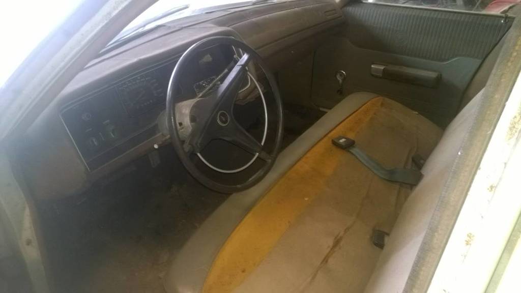

For Sale 1972 police fury l 440ci
I am out of touch. Is $7,500 a reasonable price for that car?
When it comes to cars that are old and relatively rare, it is worth whatever somebody is willing to pay for it. These police cruisers have an estimated survival rate of less than 5% due the the fact that most were parted out for the engine and transmission.
Dave
ref. the question of values of ex-squads.....I compare this car to mine.....mine is a 1970 Fury III, motor was rebuilt, needs nothing for bodywork, interior and has all emergency equipment......someone made me an offer earlier this year for 18k and I politely refused.....you probably would have between 20-25k invested when done to match my car. Now arguably is a '70 more valuable and has interest/price gone up and by how much. Be informed, do your homework and be ready to purchased based on the work you have done. The more homework you do will validate the purchase especially when cost of restoration surprises come up. In other words you will still love the car and be happy with the purchase. All of my cars I try to maximize the spread between amount invested vs value of car.

I am out of touch on car prices. Is $7,500 a reasonable price for that car?
this asking price ... on the surface .. doesnt offend my sensibilities. i'd wanna see it in person before paying anything that started with "7".
with a few questions of seller, id pay up to $5k for it without seeing it in person.
thats just me...opinions of course may vary.
