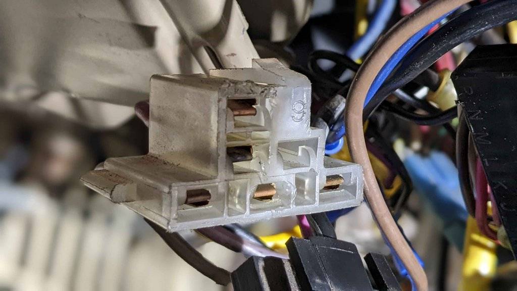

This is the connector for the Delco ignition switch that came with tilt columns. Standard column connector will not work.
Want a new connector or excellent used connector to match below: Connector, female terminals, and wires must be good. Do not care so much about condition of flat Chrysler connector at opposite end of wires.
Please post pics and price

Picture below: one of the top mounting clips is broken off.

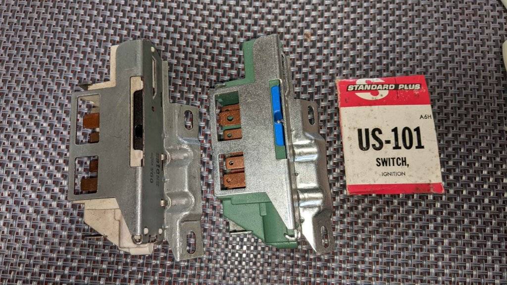

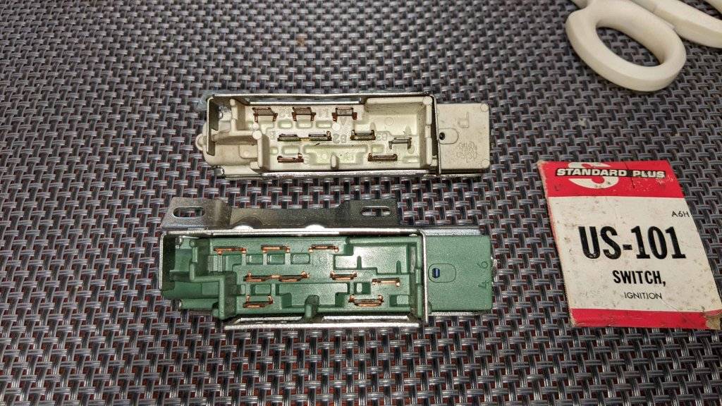

Ebay ad for new switch says, tilt column ignition switch is same 1970-1976.
Connector may have been produced for 7 years.
Switch blades. Green casing is NORS. Wanted Connector installs on left side in picture.
2 clips engage bottom square opening in picture.

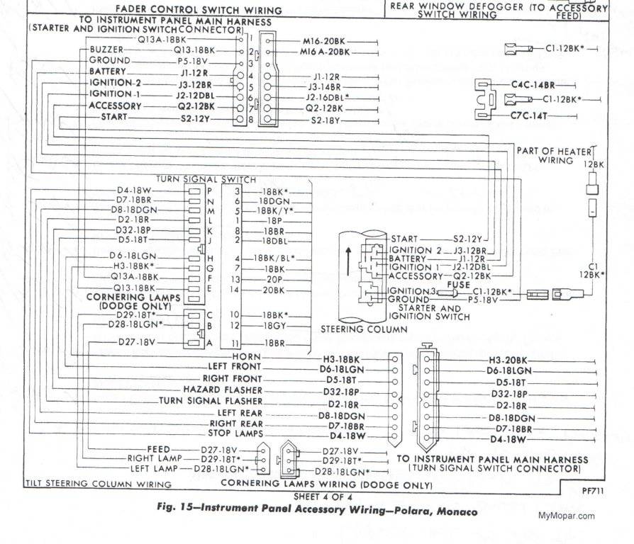

Hey go into your wiring diagram see if you can find a part number for it. Find one PM me it might be able to find one.

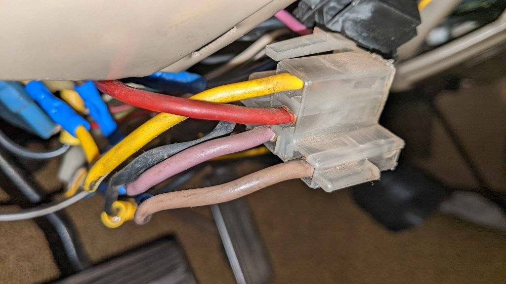

I would still like to have the connector, but I drilled a hole in the original connector where the battery input wire terminal was. It was the only terminal that had corrosion. I connected the connector to the new switch. Battery wire: I used a regular female spade terminal pushed thru the drilled hole onto the male spade of the switch. DURING CRANKING:
Ignition Switch
Voltage input is 10.7V,
Output at starter wire is 10.6V.
Ignition switch is not the problem. Bad diagnosis on my part. I'm going to try starting a new thread.
Page 8-54 in the IPB has pictures with part numbers.
My mopar has it online section 8. To many that look similar and I dont have the plug in front of me.
