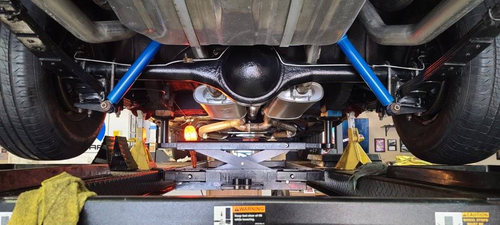

Hey Rip, yes, they have been installed. I would think they will fit your 73 fuselage, as the mounting points can't be much different from my 71.
Here's a pic. (I painted them to look like old school shocks)
