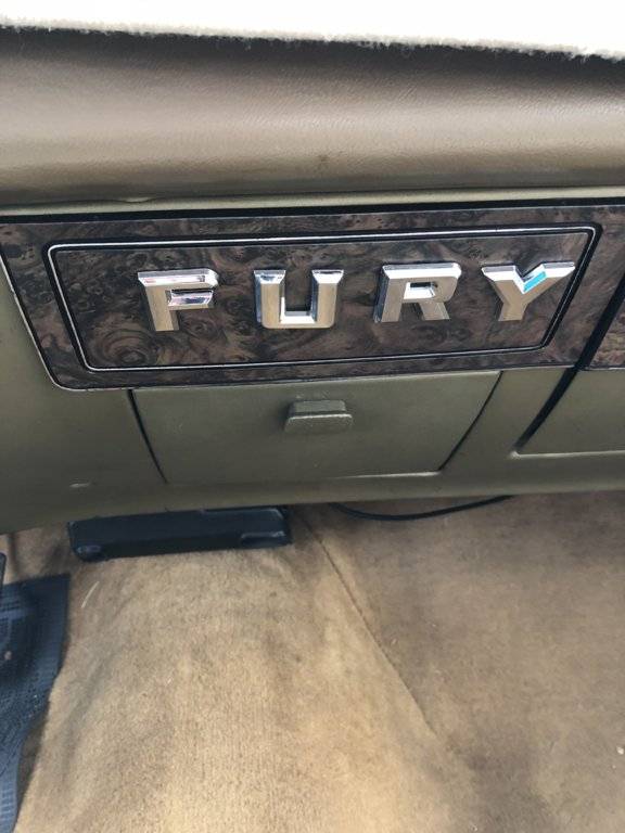

Dental floss. Loop it around the back of the letters and "saw" them off. You may have some residue left, but that should take it off with no damage to the woodgrain.
3M adhesive cleaner is a gentle solvent which works very well for removing sticker goo. As with any chemical, test in an inconspicuous spot, if there is one.

9-7-18 FURY on woodgrain, Letters remove
· Letters: remove with unwaxed dental floss
· Adhesive: remove with Goo Gone
· Whole job probably took 15 minutes and 10 minutes of that was finding supplies and figuring out what I did with the Goo Gone. Spent months wondering how to do the job. This is the one time I’m thankful for cheap parts, especially cheap adhesive. Thanks everybody for your help. @Big_John, @Newport 66, @73Coupe

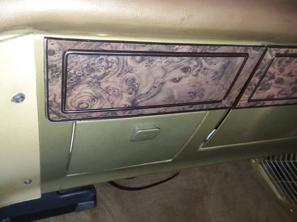

Before
After (Dash is dark gold. Sorry my phone camera keeps turning dark gold into green. Not sure how to fix that.)
Before
