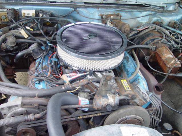

I finally installed the Edlebrock intake, carb, and air cleaner. What a difference that made. I eliminated most of the emission stuff. Coupled with duals from the manifolds back with flowmasters, she runs and breathes very good. I'll check fuel mileage and see how far past the 10.5 mpg she has been getting. I have a nice set of Mopar Performance finned aluminum valve covers to dress it up a little.

Nice job! How long did it take you to do the job? I did mine over a weekend, but I bet there are guys out there who can do it faster than that with their eyes closed. Are you going to have any linkage issues what with the E-brock intake being taller than the factory piece? I had to fab a piece in the linkage so that my trans would shift correctly, or maybe its not an issue for the taller 440.
It took me one complete day with the help of a friend. The biggest time saver was triple checking my parts list and figuring out the mods for the linkage. I had a problem with the left front of the intake hitting the A/C mounting bracket. Had to grind about 3/16 off the corner, no problem - it wasn't part of the sealing surface. Had to use a 1481 bracket for the carb. All of the rest of the linkage I took off the TQ and the linkage all hooked up. Transmission kickdown works great. I still have to hook the cruise control linkage. It looks like it'll bolt up with the factory linkage.

Great. That can be removed now too. Do you see any other unecessary stuff I can take off. There's a lot of emission looking stuff that I have to research to make sure it something that I don't need.

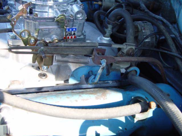

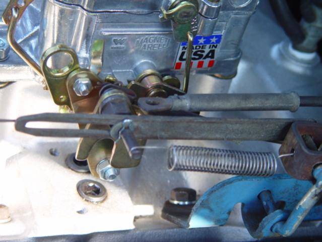

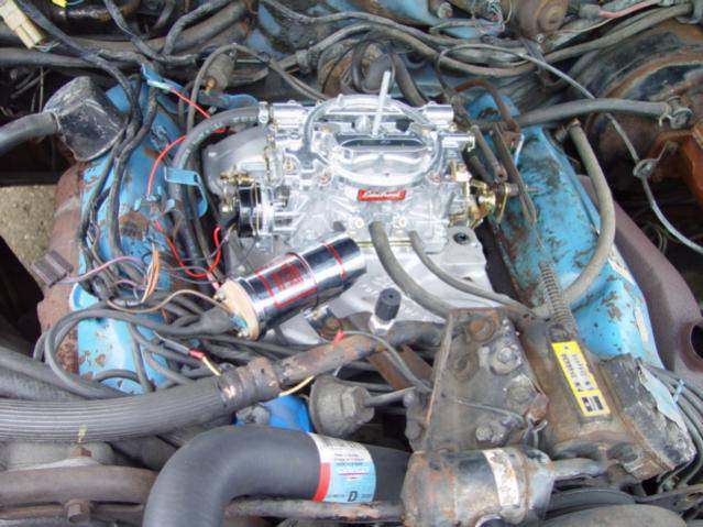

Are you going to have any linkage issues what with the E-brock intake being taller than the factory piece? I had to fab a piece in the linkage so that my trans would shift correctly, or maybe its not an issue for the taller 440.[/QUOTE]
Here's a picture of the linkage. I still have to take a pin off the TQ to hook up the cruise control cable.
View attachment 2368[/QUOTE]
Looks almost exactly like mine....but I started out swapping original 2bbl carb for the 4bbl Ebrock and intake. I had to find a big block 4bbl carb linkage bracket to replace the 2bbl setup, and I think maybe my kick down rod is a little shorter on the topside. I had to lengthen it's reach to the carb linkage so the transmission would shift correctly.
Is that an AVS carb?
