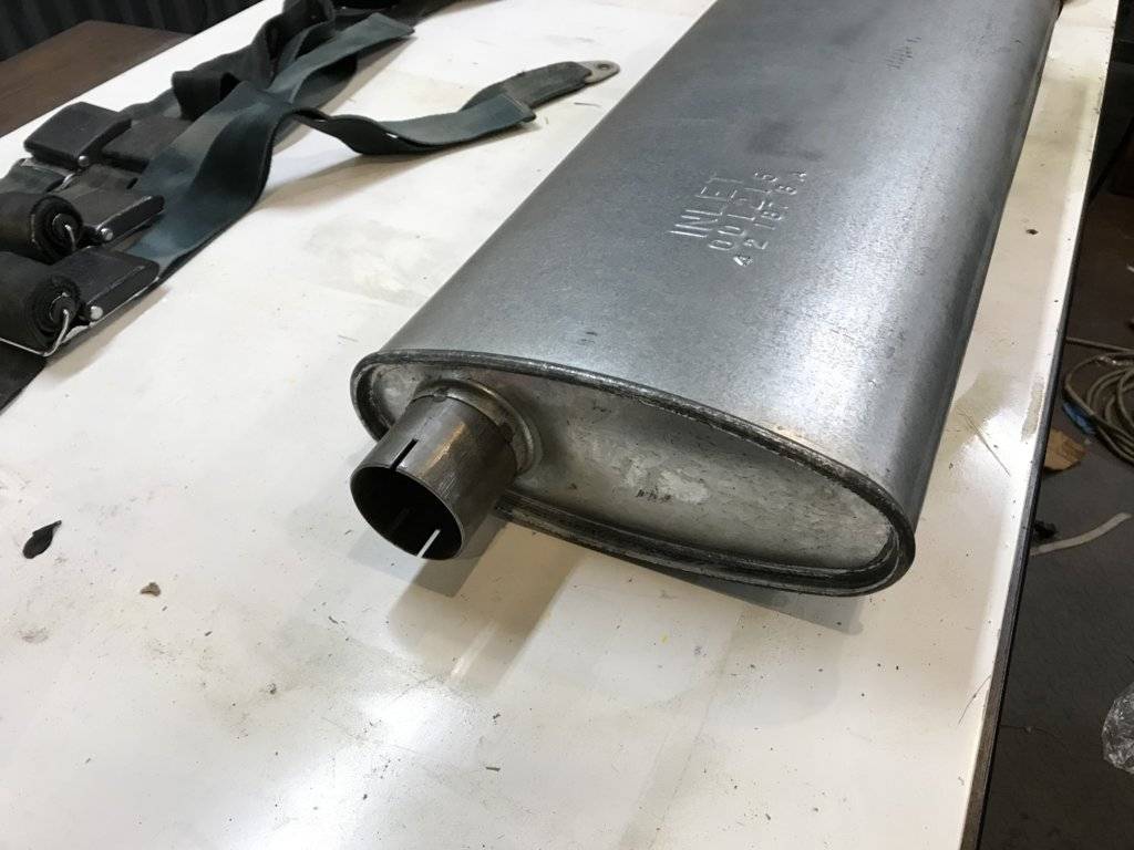

Thanks Will @FURYGT for the muffler. I may as well document it here as well.
P/N 2660525 single exhaust muffler zinc coated.
‘68 383 w/2 bbl P, D, C-E, C-L
W/440 eng C-M, C-H
w/o H/Perf Y
Oval can 25-1/2” long, 4-1/2” thick, and 11” wide.
2-3/8 outside diameter of inlet and outlet, 2-1/4 inside diameter.
Inlet offset to one side, outlet is in the middle.

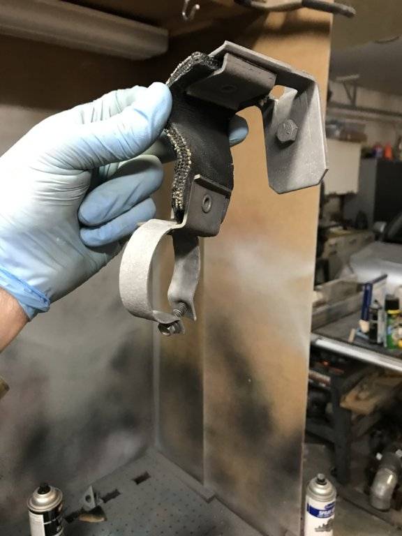

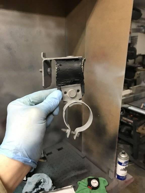

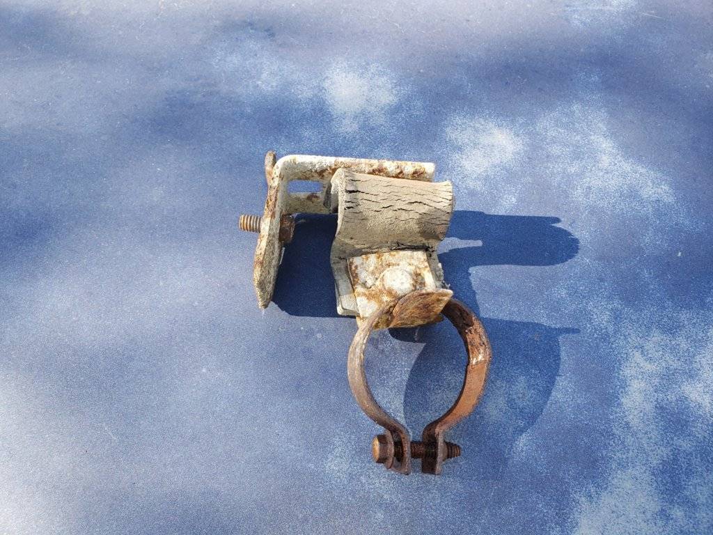

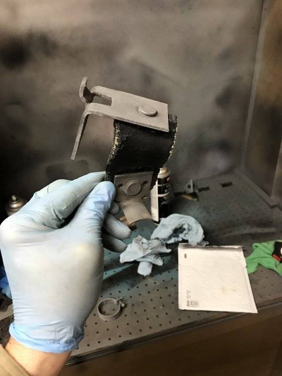

Thanks to @68plymouth383 I received an original exhaust hanger. It cleaned up nicely. Soaked it in my solvent tank for a few days which loosened up the old undercoating an actually softened the rubber. Sand blasted it, acid etched it to give it a little bit of a zinc phosphate coating and then tin zinc coated it.
Some day when I find the right rivets. I will replace the rubber.
From this.
To this.
P/N 2660436 hanger above for future reference. Used 66-68 Dodge and Plymouth, with 383 single exhaust.
From this.
To this.

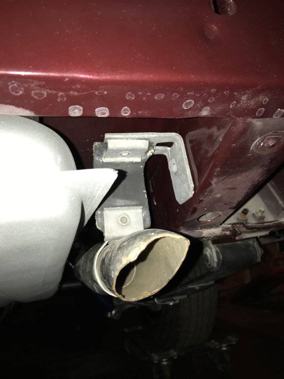

For the NORS hangers you found I am pretty sure I would have to turn the bottom of that hanger around for it to fit right. There is only 4-1/2” of pipe that the hanger can go on. I hate to spend that kind of money and still have to rebuild it. But if I find that is my only choice... I will do what I can. I will need a 2” clamp for sure though.

I gave them a quick coat of engine aluminum paint and engine clear coat.
Not bad for $60 for the pair
