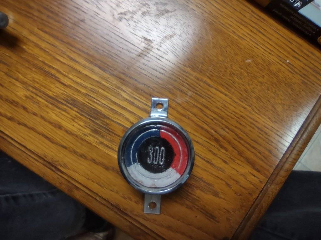

Does any one know how this emblem made of clear plastic is attached to the steel base? Colors are gone and id like to repaint it.

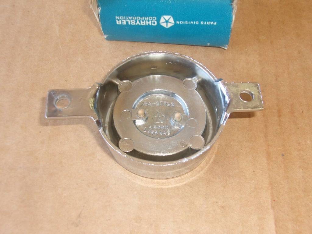

Looking at the back of this NOS piece I found on eBay ($250! gulp), it looks like the plastic has a couple pins that were pushed through and then probably heat "welded" in place.

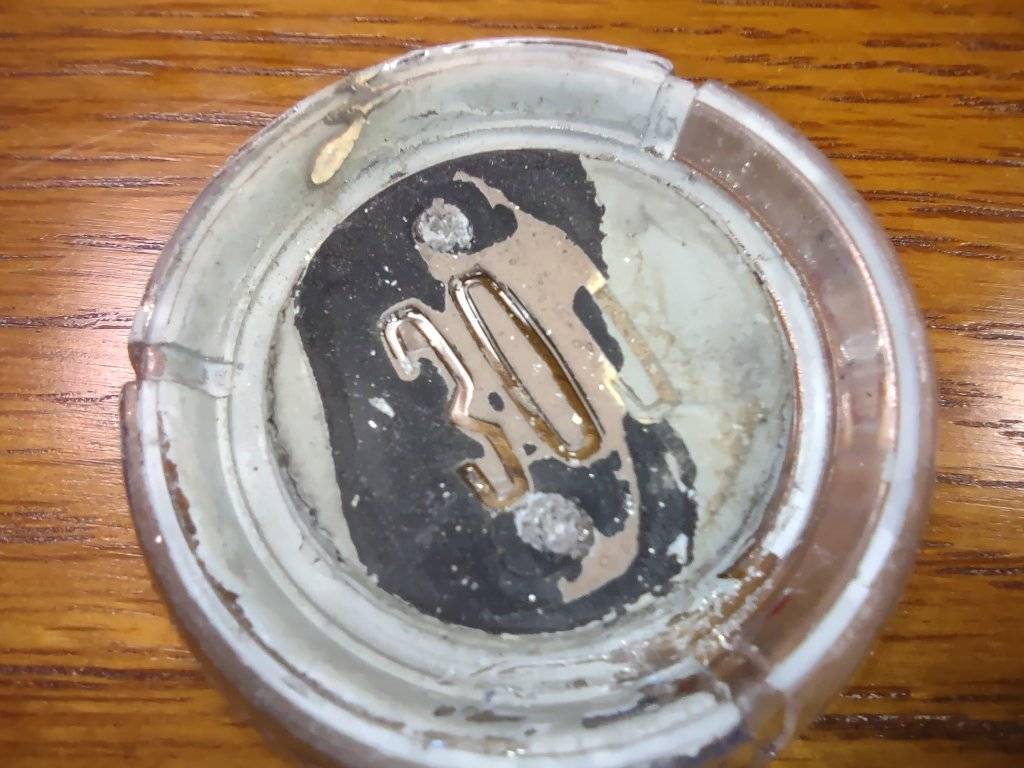

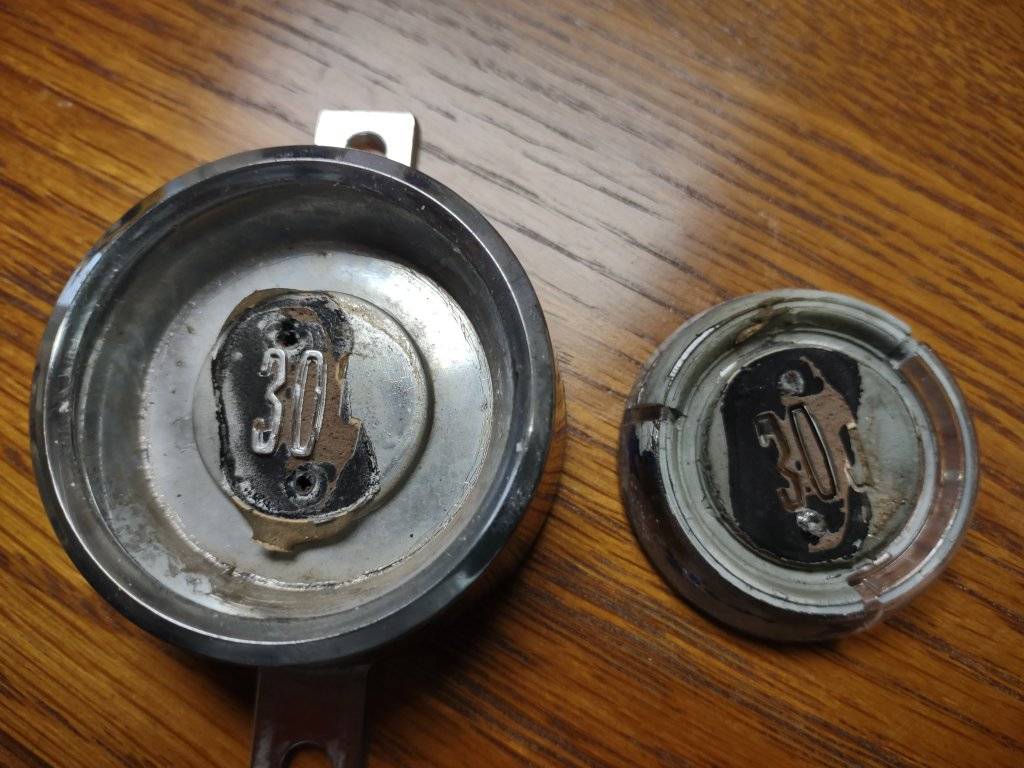

Well finally got it apart. Lots of heat and prying. The plastic disc is one piece. The colors are indeed done from the back and then a gray blackout is sprayed over that. The 300 emblem is inserted plastic, chromed letters. Two of the numbers stuck to the metal and one stayed in the plastic.
Ive never seen glue this strong on metal. The pins sticking thru the back were just for alignment so now the repair starts.
wow, that's gonna take some finesse to get all cleaned up, painted, and reassembled. Can't wait to see how it turns out!

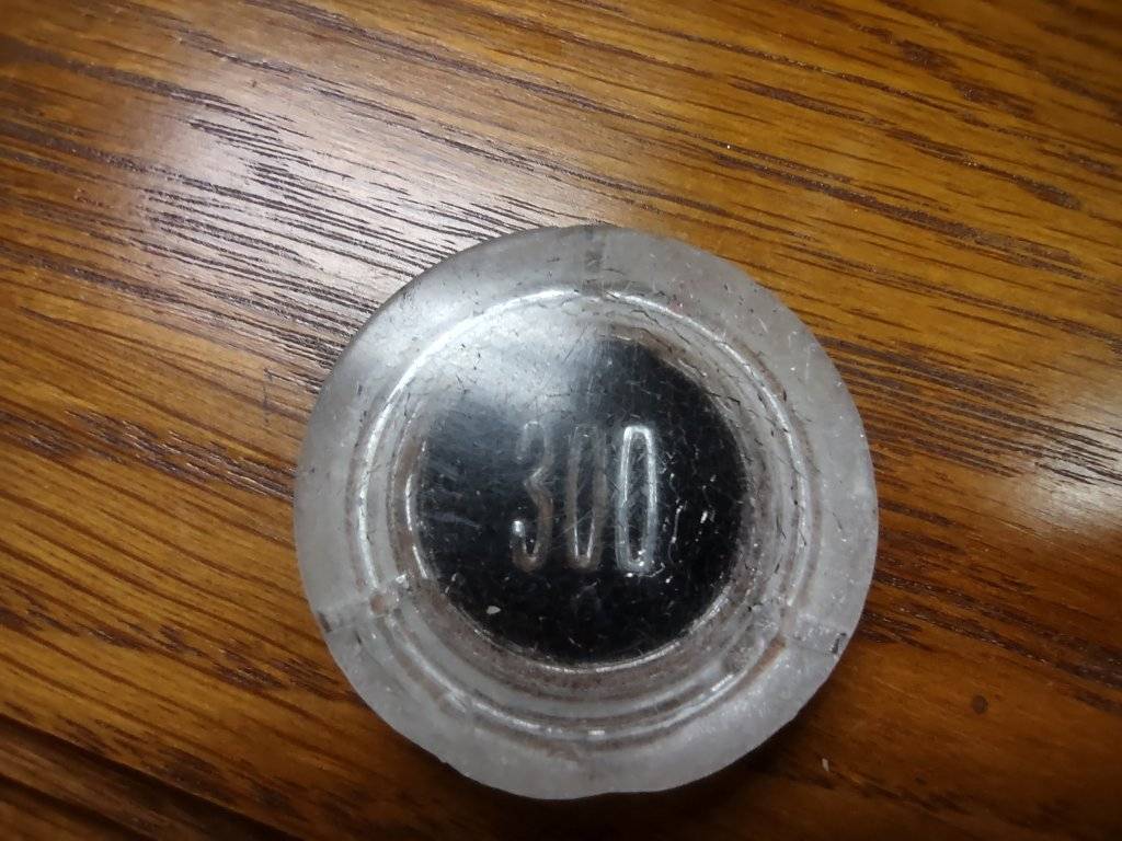

Dont try it. After cleaned up you can see the little crackle in the face.
Secondly, you cant get to the chrome circle around the 300 word. It appears the 300 black center was made and painted and then inset into the resin emblem. I painted the inside edges and the paint seeped slightly under the 300 piece where the chrome circle was but it wont soak in evenly so its spotty under there. Then with the worn and crackled top layer, the colors underneath looked uneven and washed out. Ill play with it a little more but checked junk yards for a better one or see if my artist friend can make a new one.

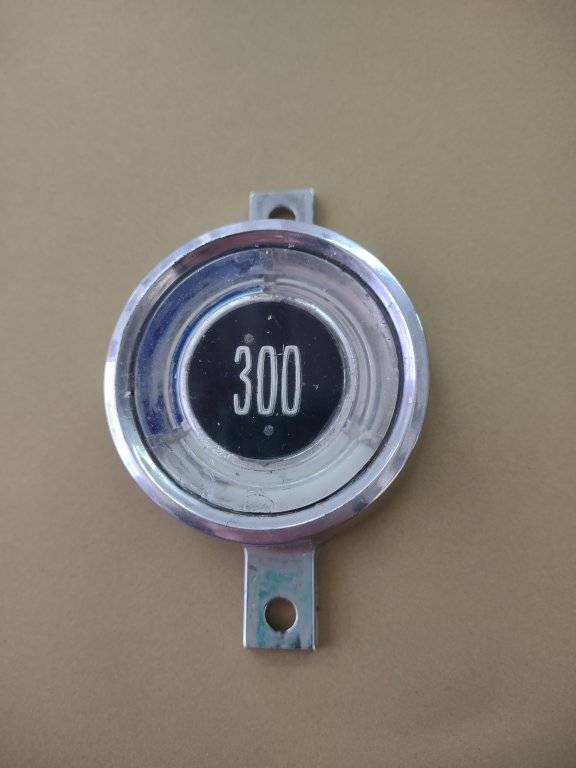

The flat paint seems to be working better. After it dries, i paint it again and it slowly moves under that piece and looks good. Have to keep paint light so it doesnt spread haha.

Well considering how beat up it was, im satisfied until i cant find or afford a better one.
