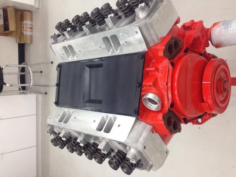

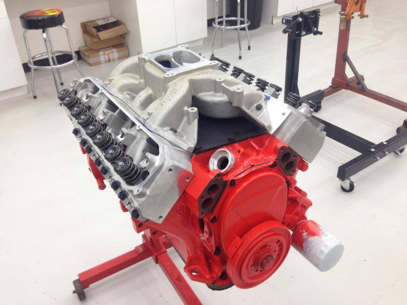

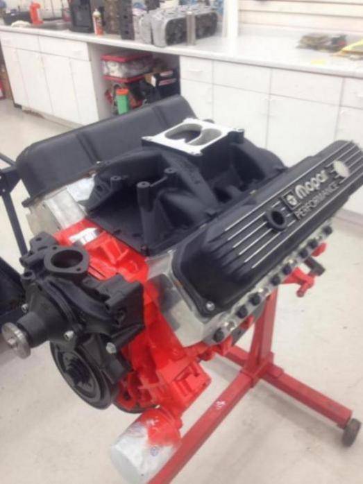

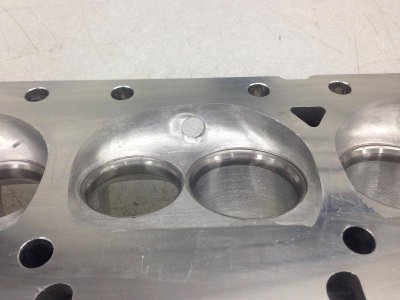

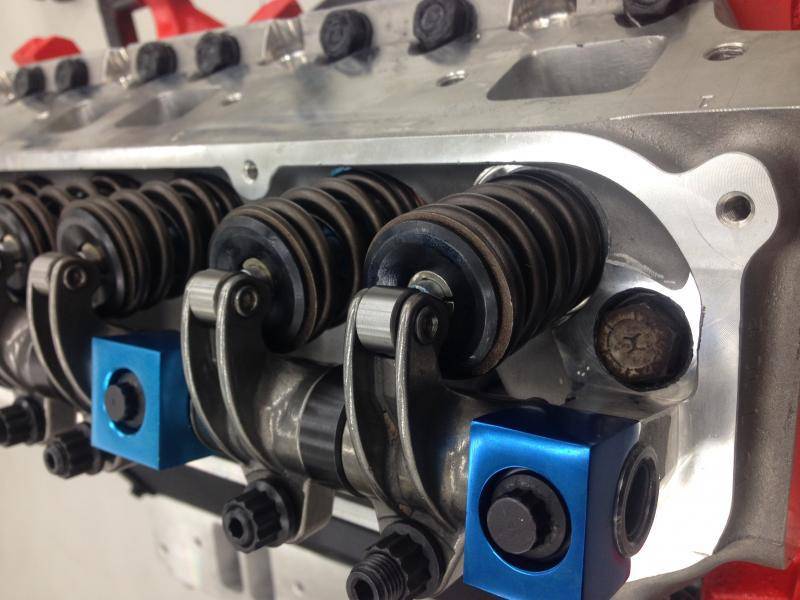

Almost done with my 383 I had sitting around. I was going to put it in a 85 4x4 pickup (painted like the General Lee) But sold the pickup. So I hopped it up a bit. Just need to finish painting intake, water pump/housing balancer etc.
Will be on the dyno soon!
69 Block .030 over Zero decked Align honed Deburred
10.2:1 compression
KB pistons stock rods (race prepped rebuild with ARP bolts)
Balanced stock forged crank (.010 rods from factory)
Truck rear sump oil pan with windage tray

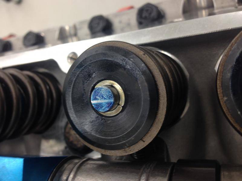

Bullet hyd flat tappet 242/246* 598/608 108* cam
Comp lifters
CV products pushrods
Stainless 1.6 roller rockers

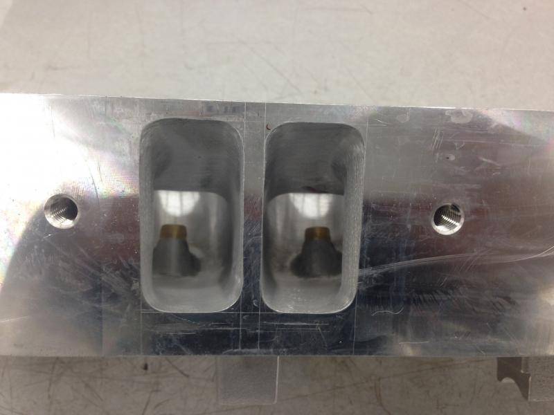

Fully custom ported aluminum heads with 2.14/1.81 (11/32 stem valves)
Valley plate

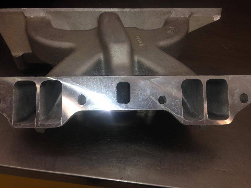

Custom fitted/ported RPM intake
850 Demon carb

Very nice, Don't skimp on the balancer. Fluid dampner is my choice. that motor is going to be a screamer.:icon_cherry:
