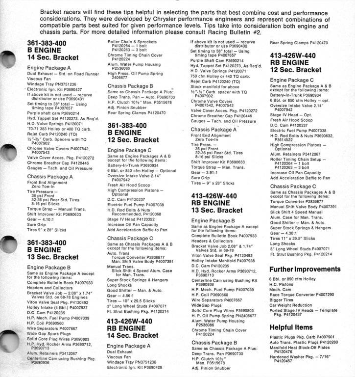

How about we go directly to Mopar and get their view on building a street/strip engine. There might be something here of use.
It's been a while since I've seen that page! Guts, Chrome, Settings . . . Seems like the Purple Shaft "214" cam was the old Street Hemi cam for normal B/RB engines? I believe those ET recommendations are for "B" body cars? Might need a vintage Direct Connection Race Manual (about 1000+pages) and a vintage Direct Connection catalog to decipher the part numbers.
CBODY67
