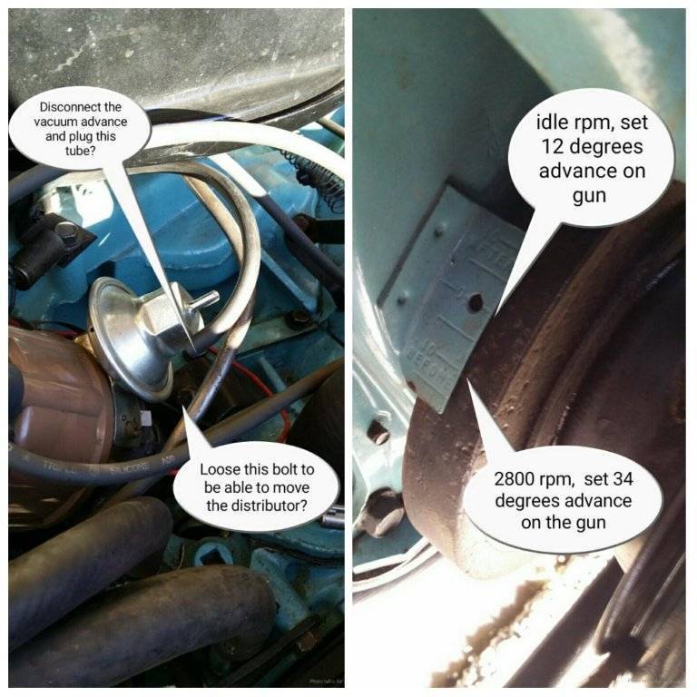

With that vacuum gauge and a good ear "listen" to what the engine wants.
With engine running,turn in the driver's side idle mixture screw all the way slowly stop right before she stalls.back out by 1 and a half turns.Do the same next side.
Gauge still shaky?? in 1/4 turn increments out,and keep watching the vacuum. If it increases,the engine will smooth out and idle up a little.
It is normal with an engine with some miles on it to have one screw in/pout more than the other--what ever it takes to make it happy.
Goal is have a smooth idle and steady vacuum gauge needle.
If you cannot get any more vacuum by adjusting the screws,bump up the timing,and set the idle.
Remember 18-20 inches makes a 383 happy.
If you have a timing gun with the advance feature,use it.
My last 383 tuning adventure likes 34 degrees all in at 2800 RPM. 10.5-11 degrees all in.
The huge increase in vacuum past 25-30 inches when decelerating tells me engine has some miles on it and possibly minor blowby passing through the rings.

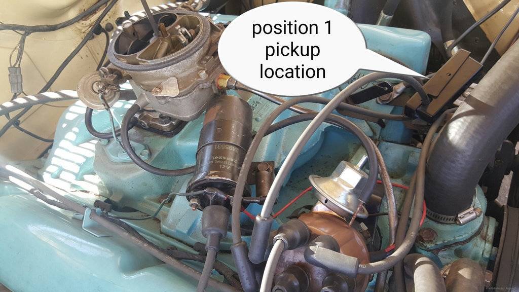

Your timing light should be much more consistent in its flashing of #1 It is cutting out on you.
Make sure your lead is installed in the correct position and on #1. make sure spark plug is tight and boot is on all the way.
You are on the right path. Test and tune,drive...test and tune,drive. See what the motor likes.
Like a drum kit....Bass,snare,high hats. RPM's,timing,vacuum.
Make sure there is no ping under a load. If there is you can (a) fatten the mixture,or (b) turn the timing down a notch. keep the vacuum at minimum 18 inches,20 max. Keep the idle at 750-800 with today's gas. Anything lower she will load up or stall at the lights.
BTW,Every time you adjust the timing DOUBLE CHECK the timing after you tighten down the distributor to make sure timing did not move. Clamp it down good to avoid any movement when driving.
I had seen too many people complain the timing moved after working on it by leaving it tight enough but loose enough to move by hand..
Always as close to plug as possible without burning the gun's collector.Thanks for quick reaction. I put the signal collector probably too far from spark plug 1 as shown on the picture. Should it be as close to the spark plus as possible?
your signal collector is good. spark moves at speed of light. intermittent flash could be from low firing voltage due to bad or fouled plug. points distributor. ever hear of dwell? if timing changes with air cleaner on or off, you have larger problems. nice car. cbarge rules!
