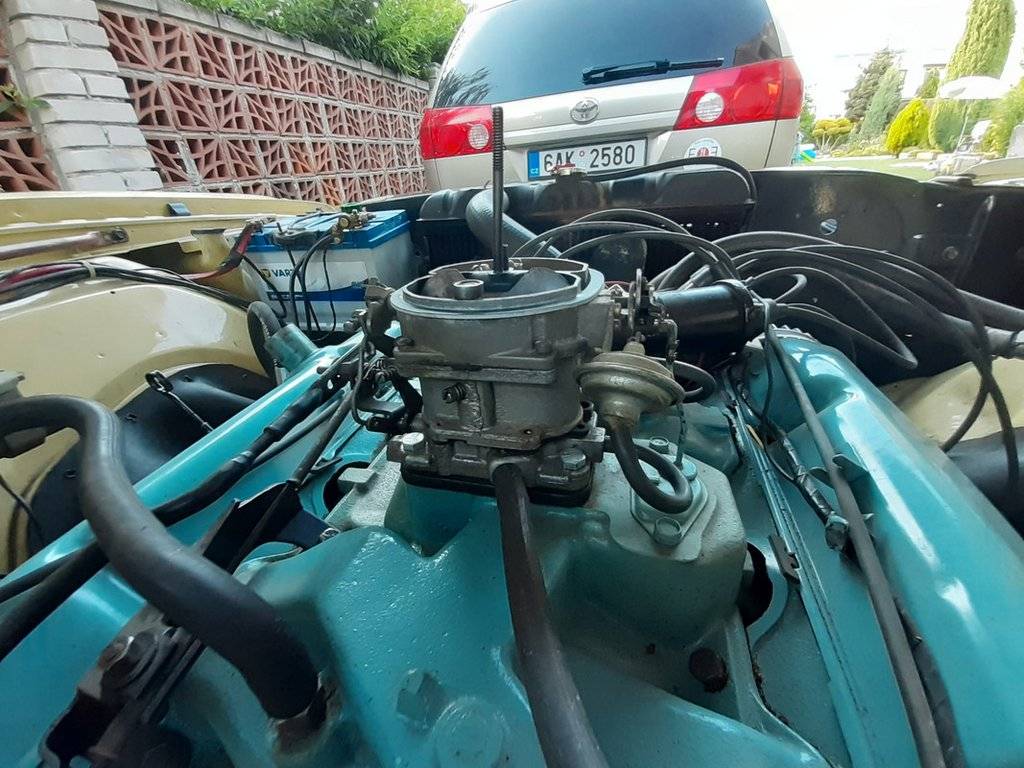

The second part of my questions is related to the vacuum choke setting. I should test its functionality by sucking the air from the hose, to see if it makes anything, well next time I will try.
But I´m more concerned about the play on the end of its tracks. The metal rod going from the manifold does not allow to close the butterflies of carb completely until the stop position is reached on the other side of the carb. The rod is too short, for the test I removed the safety metal clip. Shall I bend it to make it a little longer? Next, vacuum canister controls another rod, but in its track have dead ends on both open/close positions. Again, shall I try to adjust the position of choke vacuum canister or that rod to eliminate dead endplay?
I did try to make a short video of the choke control play, to better explain the current setting.
Few pictures

I will try to do a video comparison of my choke set up as it looks similar to yours
Here is a video of mine with narrative. I hope you understand my North Dakota accent. My Czech Colleagues in Dobris can. :D
If you have any more questions let me know. I have found that some of the advice for 4bbl or HP engines is not always accurate for 2bbl
I noticed you have a fairly thick thermal gasket under your carb, which will definitely change the length and contact points of your choke thermostat linkage.
If I recall correctly I the tried to use one in my rebuild kit and my linkages lost clearance and of course screwed up the choke linkage. I think this could very well be the original gasket, at least been on there since I took it over in 1984. It has metal bushings in the holes to keep from over tightening or squishing down to far. There are no bend marks on the original thermo actuator Rod.
