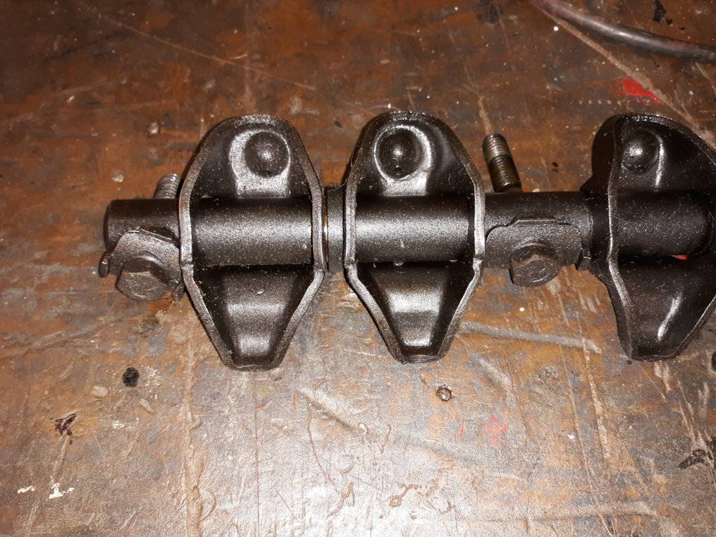

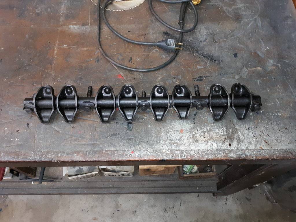

Took a look at my 440 shaft yesterday.
My mistake: forgot that shaft oils from the shaft stand bolt hole instead of a separate passage all the way to the shaft.
Also important to note that though shafts are interchangeable, rocker arms have different offsets. I always put a coat hanger through mine, so I keep them in exact same order while cleaning the shafts.
Nice to see that your paying attention to details. Most people would just tear it apart like a tornado, then wonder why they can't get it back together.
