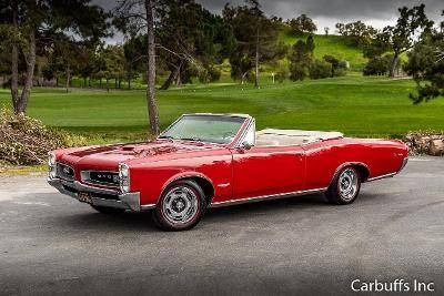

The Sport Fury is somewhat "easy' on gas but my other "toy" has the credit card hanging on the key chain for quick access when I pull into a gas station; which is often! I need to keep my lead foot off that accelerator! Like the song says "three deuces and a 4 speed and a 389" SLURP, SLURP! Ahhhhhh, so good! Bought it last summer while my Sport Fury is having a complete off frame. Interested, Check it out:
1966 Pontiac GTO Convertible | Concord, CA | Carbuffs | Concord CA 94520
