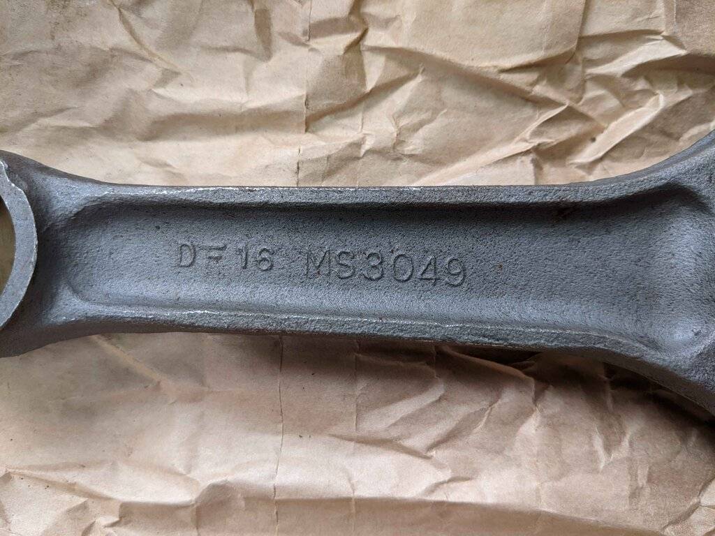

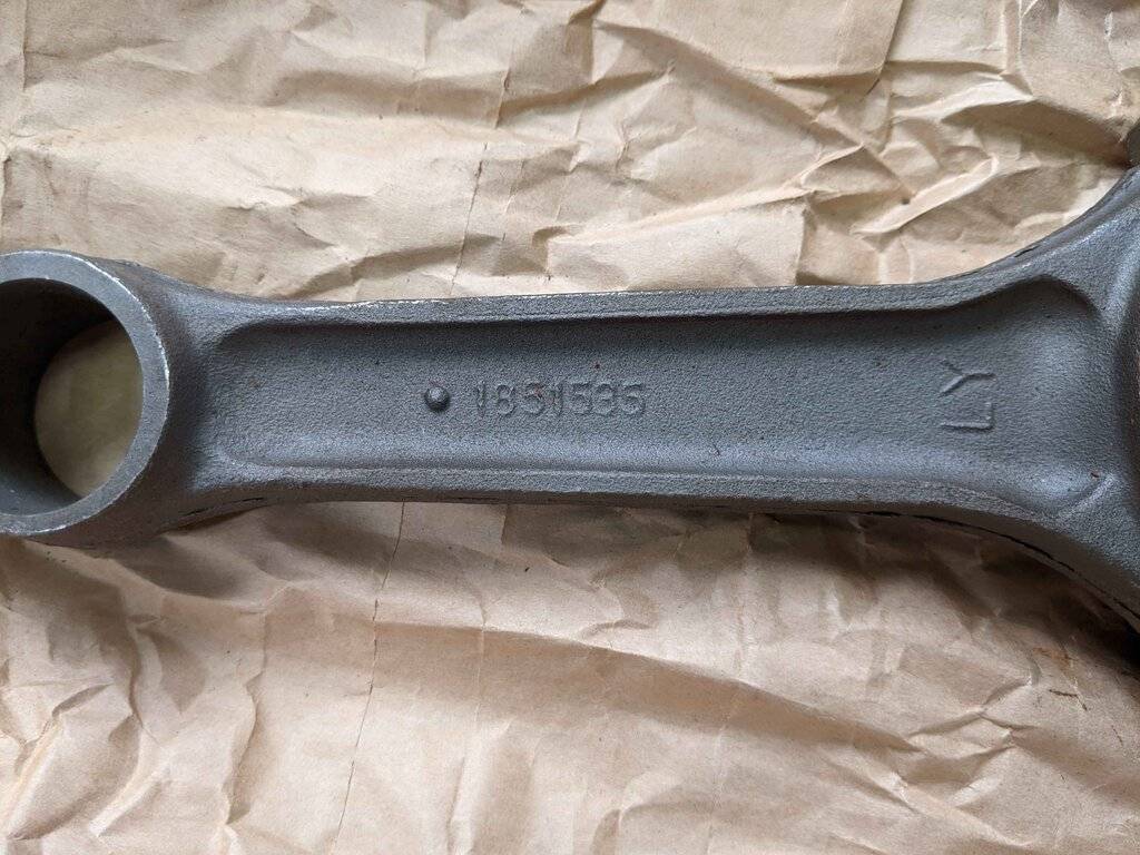

I have a 1971 440 long block that I bought without connecting rods and pistons. I recently purchased 8 rods through the mail
· casting number: 1851535 LY on all 8 rods
· on the opposite side of the rods, the DF numbers varied.
· Stroke: all had the same stroke, but some had more metal above the piston pin than others.
· The DF numbers probably mean different runs and different years, although it would be interesting to know what DF stands for. The rods are numbered 1 through 8 at the rods and caps, but with the difference in height above the piston pin, how hard are they going to be to balance when I rebuild the 1971 440? THANKS!

They won’t be hard to balance at all. It’s good that they have never Been balanced yet.
The stroke of an engine is sent by the length of the crank jourmanls from center. The rods don’t set the stroke.
Its not a long block if it doesn’t have rods and pistons,
A block with just pistons, in the OEM realm of things is termed "fitted block". Just as a block without the rotating assembly is a "bare block". "Short block" has the entire rotating assembly installed in it. "Long block" is a short block with the cylinder heads installed. FWIW
The "pads" on the pin end and also on the rod caps are the "balance pads", which is where the rod's weight is adjusted during the balancing operation. Factory production rods usually have smaller/shorter balance pads than a single rod which was purchased from the parts department, by observation. The trick is getting the rods and the crank they were originally with. Which then leaves just the pistons to worry about balancing. Which is what my machine shop operative did, he'd call his brother that was in the engine core business and order up a matching crank/rod set when he was building a motor that needed a crank and such.
Tracking the casting number should reveal the original application of the rods.
Just some thoughts,

Casting 1851535 is the stock 440 light duty connecting rod that came on 440 engines 1966 to 1978, regardless of forged or cast crank.
