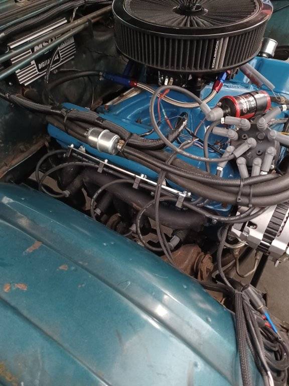

Distributor and MSD box installed. Car runs great. Will update later. Lots to do.

The glass fuel filter will be replaced with a metal one. I was thrashing on the car last week and got new shocks and the headers installed. I replaced the stock starter with a mini starter but it contacted the block. So i had to order a new one from summit.
My battery had a terrible draw on it so i spent some time trouble-shooting with a multi meter and found that the alternator and my new MSD box are both drawing power. A new alternator is on the way and I will need to contact holley about a replacement.

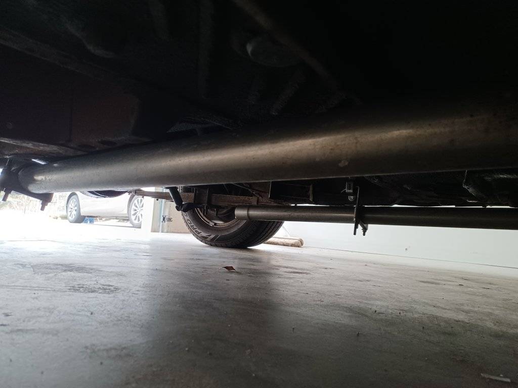

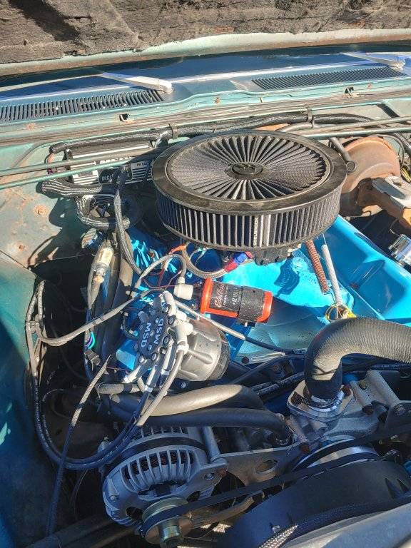

The car has the ignition system installed now, the headers got put on, half of the new stainless exhaust got installed, installed the aluminum spark plug wire looms, got the metal fuel filter installed, I assembled the willwood breaks then wrapped them in plastic wrap so they will be ready to throw on, painted the new master cylinder, new shocks, new gas tank out back (there was 5 holes in the old one), new 850cfm brawler carb, new mini starter, new transmission dip stick (old one leaked), put 1/3 of a quart of gear oil in the rear diff because I noticed the housing was covered in gear oil (i'd rather just fill it up with more oil than take the 3rd member out and re-seal it), and a new powermaster alternator because the brand new tuffstuff alternator was JUNK.
I also spent time cleaning up the wiring from the MSD box. I cut out 5ft of wiring from the harness the comes with it. I took time to rewire my electric fans properly. The fans used to be activated when my key was in the on position. I did not have the proper NPT fitting and temperature activated grounding plug to run them off coolant temp when I installed the fan two years ago. So I finally got that entire deal working properly. I did not get my electric fan for my oil cooler wired however, so put that back up on the too do list.
