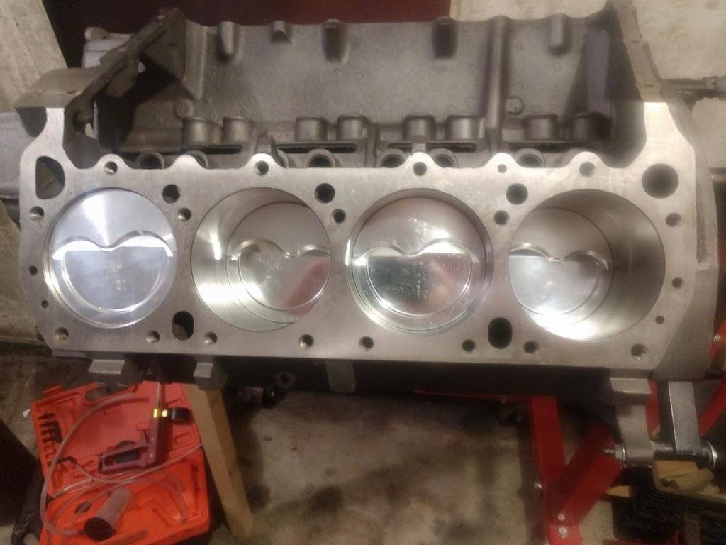

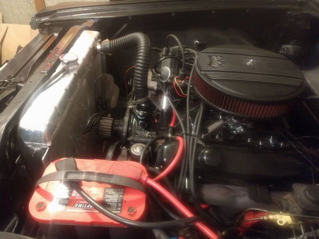

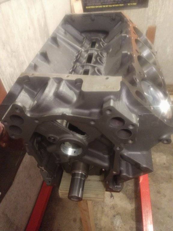

    Here is my current setup with the 383 as well as the current state of my 440 stroker/505 IMG_20190722_172156390.jpg IMG_20190722_172234107.jpg IMG_20190722_172245027.jpg
    Slowly but surely coming along..

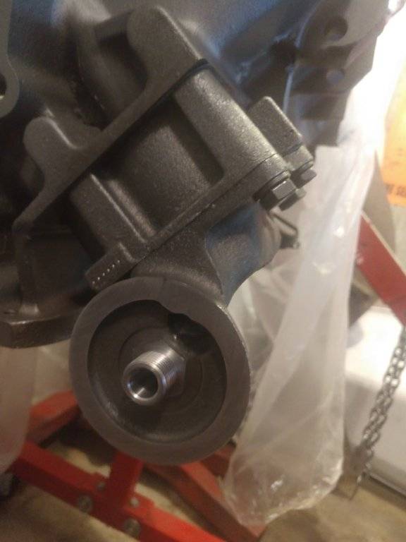

    Melling High Volume Oil Pump...check
    The build continues...
