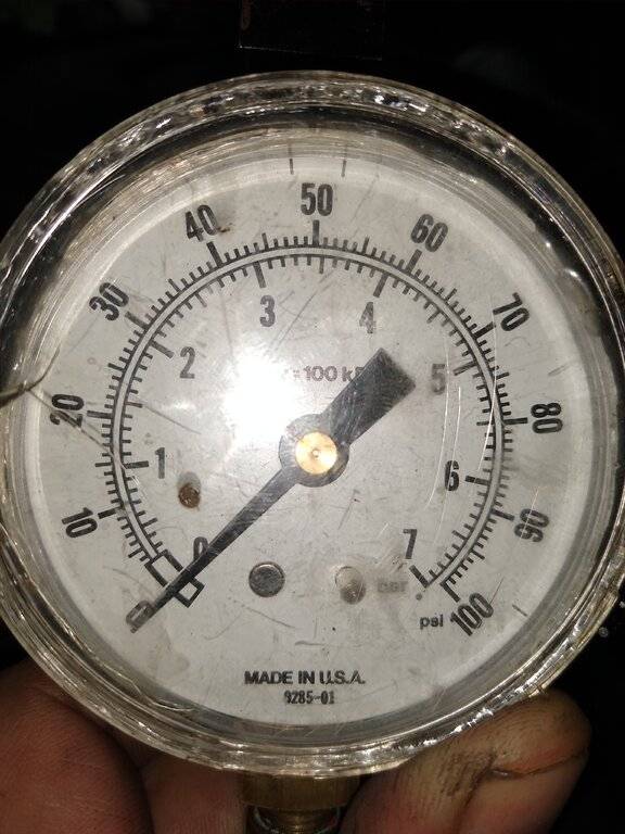

Got my gauge hooked up, really bounces. Not very accurate under 10, but it's looking like 2-5 ish. Low pressure

For a mechanical pump 5 psi is about right. Bouncing reading is not a good sign. Try running a fuel line into a gas can overnight to see if the pump is not holding the pressure. At 113,000 miles the chain is probably stretched, but the factory tensioner should be taking most of the slop out of it.

I cranked on it again, no filter, and the needle barely moved. It started
Running, it doesn't even make it out of this low pressure box. I'm going to get a carb only gauge
Weird, hooked up new gauge, no start/no fuel...
