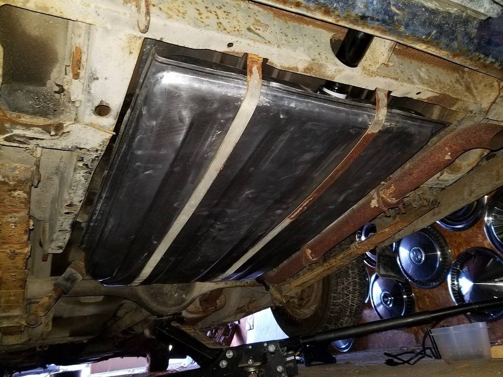

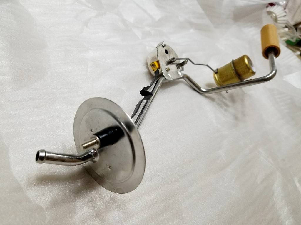

-replaced the fuel tank (brand new Spectra CR20B with the 2 vents like the OEM one)
-replaced the fuel sending unit (apparently identical to the OEM one)
![XOHLVC2.jpg](/mopar-forum/proxy.php?image=https%3A%2F%2Fi.imgur.com%2FXOHLVC2.jpg&hash=dedcd3ba0bbbb7e63a9d67fe540df451)

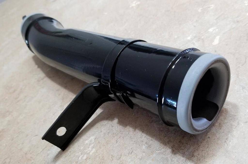

-sandblasted and repainted the fuel filler neck

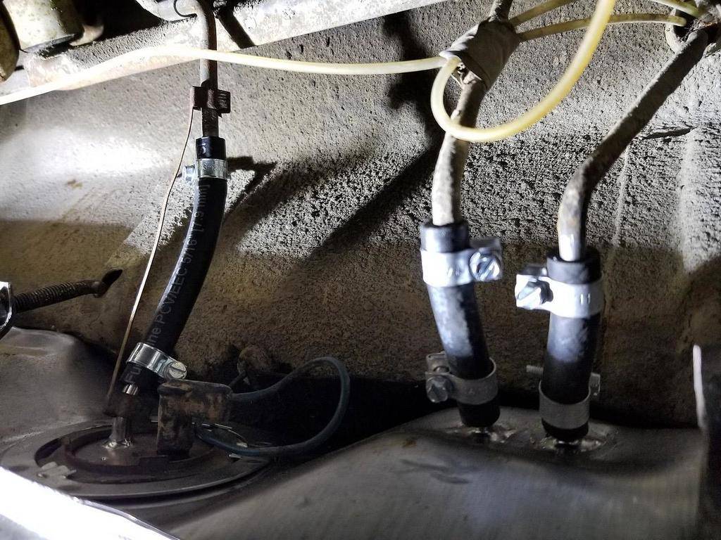

-removed all the (dry rotten) old rubber fuel lines
-cleaned up all the steel fuel lines with a compressor, apparently none of them has a hole and none is plugged either: the air comes out at the end of each of them
-installed brand new 5/16 rubber fuel lines (for carb fuel system) with new collars: one about 7in long between the sending unit and the first steel line (under the car's trunk), one about 4in long in the middle of the car (at the passenger door), another 7in long between the fuel pump and the fuel filter and another one between the filter and the copper fuel line that brings fuel to the carb
For the rubber fuel line that runs between the steel line coming out of the front passenger side frame rail and the fuel pump, I leave the old one because it didn't look dry or split
I also replaced the two fuel vents rubber (1/4) lines

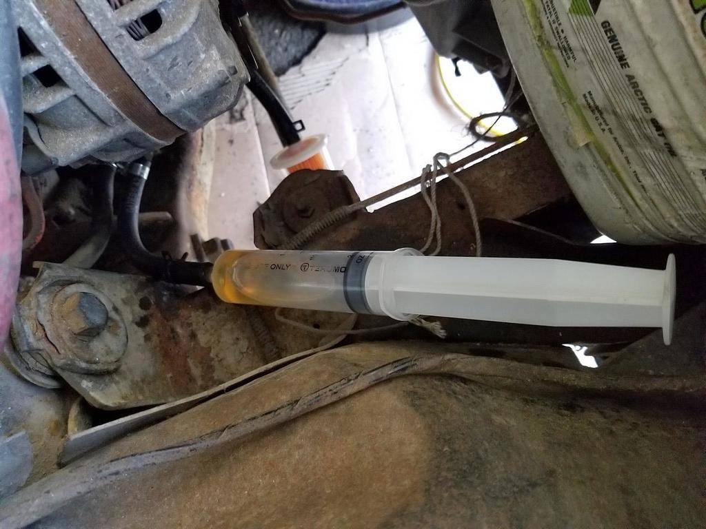

Before that I even try to suck in the fuel manually to the front with a syringe before: I connected a big syringe after the fuel pump (instead of the fuel filter) and successfully aspirated the fuel from the tank...proof that the lines are free of any obstruction
Seeing that the path to the pump wasn't obstructed I told myself that if the pump sucked as much as the syringe the gas should arrive...but it doesn't seem to work wither

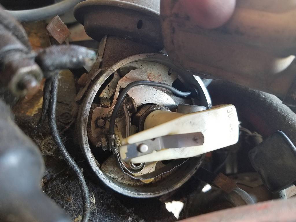

All the ignition system was perfectly working 2 weeks ago so I think it should be okay, when the engine starts (thanks to the fuel in the carb) it runs pretty well, I still checked the distributor and the coil, everything looks good
