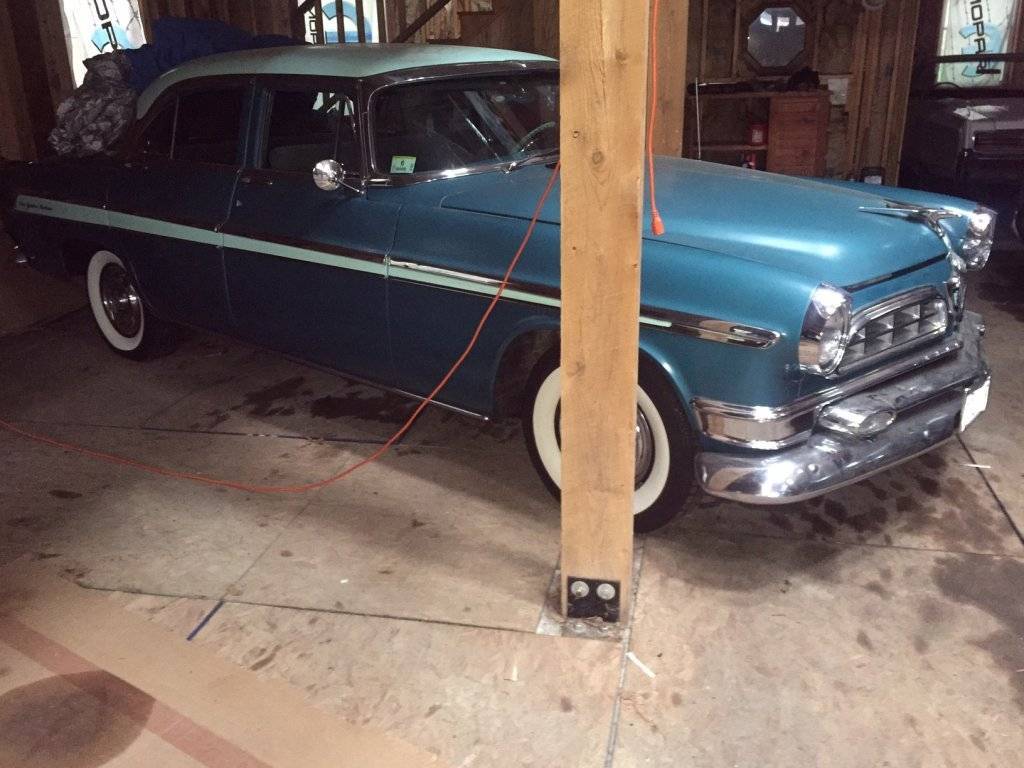

Sounds like an interesting project. I assume it is a 2 door model then? Photos are always welcome.
Those are nice cars and well built. It looks to be in great shape too. I am confident it will turn out to be a surefire sleeper.

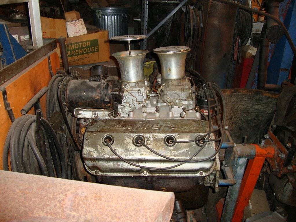

well you can do this via swap meets , its a aftermarket intake w small mouth afb's . the 55 had wcfb didn't it . there out there i might have the one that came with my nyr 331 . the 300 had a solid cam with special rocker covers also . its going in this .

no 301 331 354 are all low deck motors , like 350 361 383 b motors . 392 is a raised deck , like rb383 413 426 440 . but all low deck motors 301 331 354 could have either poly or hemi heads , 392 was only a hemi headed motor . there are more differences , up to 54 was different heads and water pump , then in 55 used the same water pump as the 392 , but heads are different do to the blocks low , raised decks . same water passages . you can put 55 56 301 331 354 heads on a 57 58 392 , but you need spacers for the intake manifolds to fit . they shear the same intakes . but cams will not interchange between low and raised deck motor , different bank angles on the lifter bores . yes they look the same but aren't . oh ya rocker covers are the same , for chryslers . now dodges and desotos are another animals again , desoto was a hemi only . but dodge was both poly or hemi , low n raised deck stuff again . but plymouth sheared dodge motors low or raised deck with poly heads only , but one year fury used a chrysler hemi . does christine ring a hemi bell . and they all early motors shear the same bellhousing bolt pattern and crank pattern and location of the crank flange . hope i helped , lol . it can be a eye opener . the pic is a 55 windsor 301 with 55 hemi heads . it came as a poly headed motor and yes thats a 6-71 huff'r with two port hilborns sitting atop it .
well you can do this via swap meets , its a aftermarket intake w small mouth afb's . the 55 had wcfb didn't it . there out there i might have the one that came with my nyr 331 . the 300 had a solid cam with special rocker covers also . its going in this . View attachment 116333
It's been awhile since I've seen velocity stacks!
Very cool!
add small mouth ones are harder to come up with . well i did swap meets like a demond for some years , grabbed as much of the stuff i could , still left some stuff on the shelves for you guys though , lol .

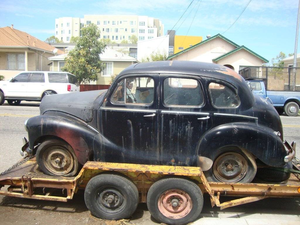

ya austin a40 is one of my favorite gass'rs of all time , had one 4dr street'r with a jap 1400cc 4bann'r in it , all the running gear from a b210 , front disc clip from a toy . i did not build it . the guy that had was moving and the wify would not let him bring it to their new place , i rim'd n tired it ( used strint style they looked halibrandish ) , header and cherry bomb'd it , primed n scalip'd it . she was a cool beat'r driv'r . this one is getting hemi'd n a type writter 727 loadflite n american magnesium rims , moon tank , convica steering wheel , ect..... just like early days of dragracing . i must add there are only ruffly 200 2dr sed's in the austin registry world wide .
