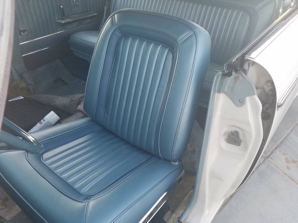

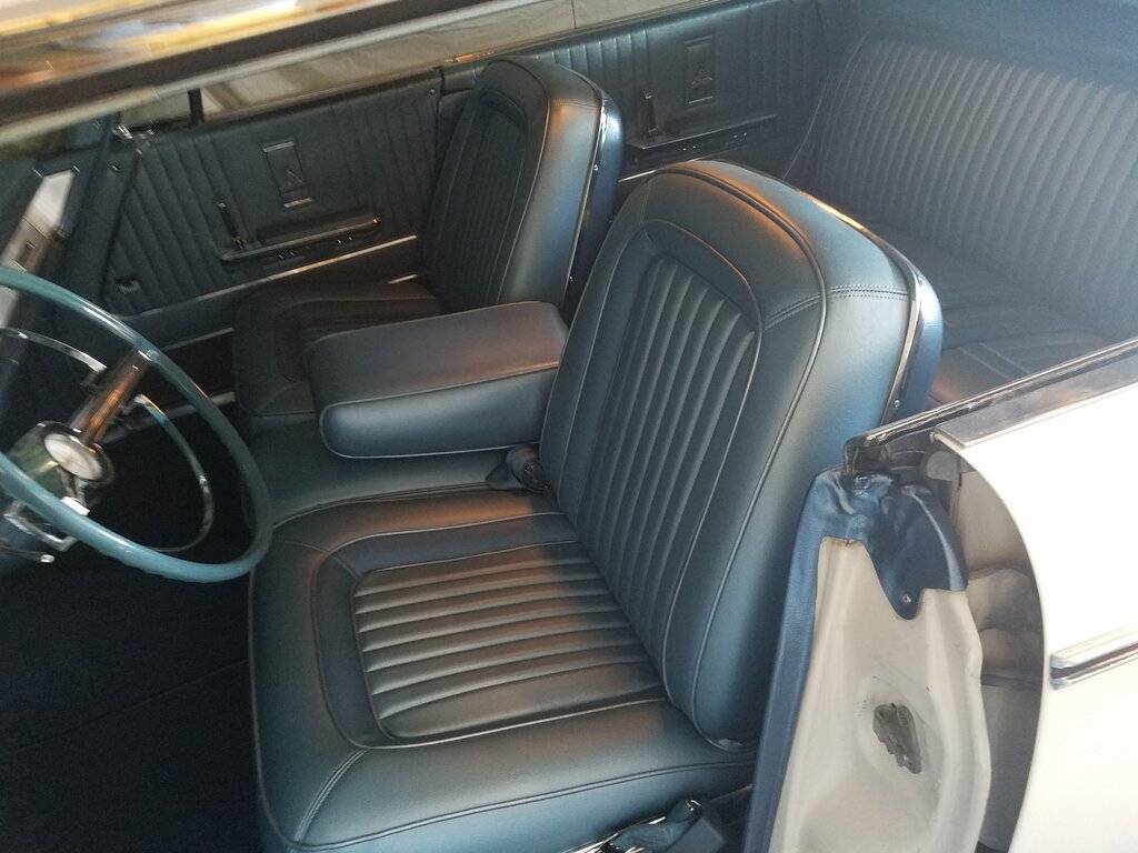

Very good post. So, I have 1964 Dodge Custom 880 Convertible. I really want to find car seat covers that spend a ton of money on custom upholstery. Since my "64 880 was derived from other models. What other model car seat covers could i use instead? I have a split bench seat in front, 40/60 split.
That's a beautiful 880!

Thanks! I would prefer to repair the upholstery then replaced the seat covers...i want to retain as much originality as possible.
I had the seats redone in the wagon , by a local shop . Pattern and material is pretty basic he duplicated the pattern and used material that was a 99 % match to the original.
