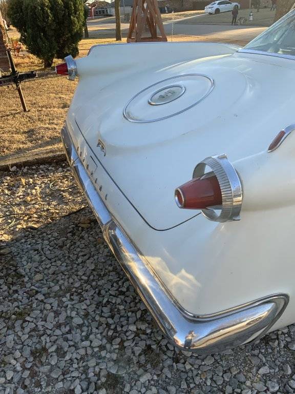

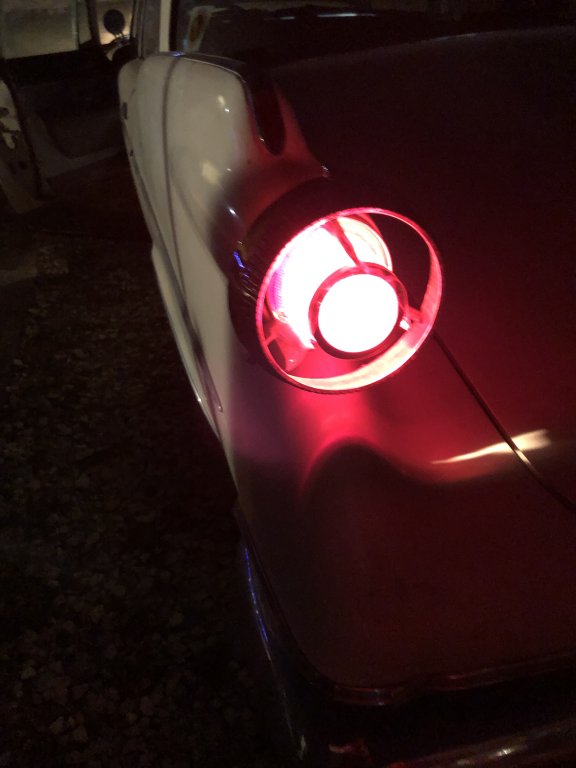

I made him a lower offer and we struck a deal . I love the 60 Imperial even better . The unique rings of Saturn look taillights with red cone lenses are one year only and very hard to find . Someone had substituted shorter Valiant lenses that would work but didn’t look right . I got lucky a guy found a pair in the trunk of a 55 Chevy he bought that the previous owner had thought of using to customize it . I drove out and met the guy and voila ! I had the correct taillights . I had already rebuilt the 200v AC Panelescent dash lights power supply on my 62 , I did the same on the 60 and its huge dinner plate sized instruments came to life again . I need to fix a couple of the tiny hair sized wires that power the red needles to make them glow , I learned on the 62 to use a drop of special conductive glue to reattach them . They are so thin they just melt if soldered . With the weight of these Imperials and huge C bodies in general somehow it seems only right it would have a cast iron transmission . So that’s the plan hopefully the hard parts are okay and it just needs a band and kit . I’ll know when I take it apart , I look forward to driving it . Thanks !

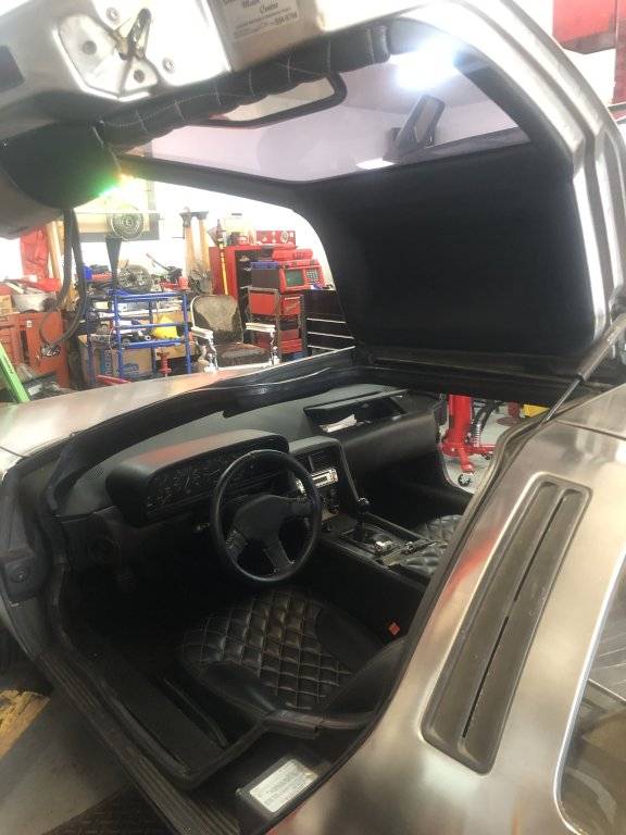

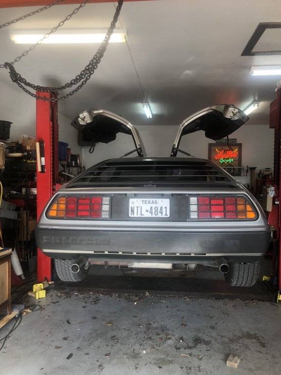

Thank you , yeah it’s heavy no doubt . I have a stout Benwil two post 60’s vintage 7000 lb lift that picks up the Imperial like it’s nothing and a good trans Jack with extra chains I put on to hold the transmissions securely. Working on the ground was okay as a kid but now not so much . I don’t think the lift even felt the Delorean I have on it now that I’m doing additional work on , after going through it front to back bringing it back from the dead for its owner a year ago . The clutch slave cylinder finally failed it’s one of the Hardest jobs to do on them with very difficult access. I’ve got it done and updated with the stainless line and remote bleeder kit that makes bleeding the clutch a 15 minute job by relocating the bleeder on an extended line where it’s easy to get to . It’s working great now . Not fun but it will earn me funds to fix my Imperial. His buddy has one with only 18k miles but that’s been sitting for years so I know it will need front to back work as well. At my age I found I kinda like working on them they are small and parts are light . I think the RV2 A/C compressor on my Imperial weighs about as much as the engine on the Delorean . I had customers with them new in the 80’s hadn’t seen one in years when I agreed to work on this one . They are way easier than new cars I see now , and I know it’s Kjet CIS injection system inside out after working on that system on most Euros years ago. Gotta do what I gotta do to pay bills and get funds to fix my Imperial .

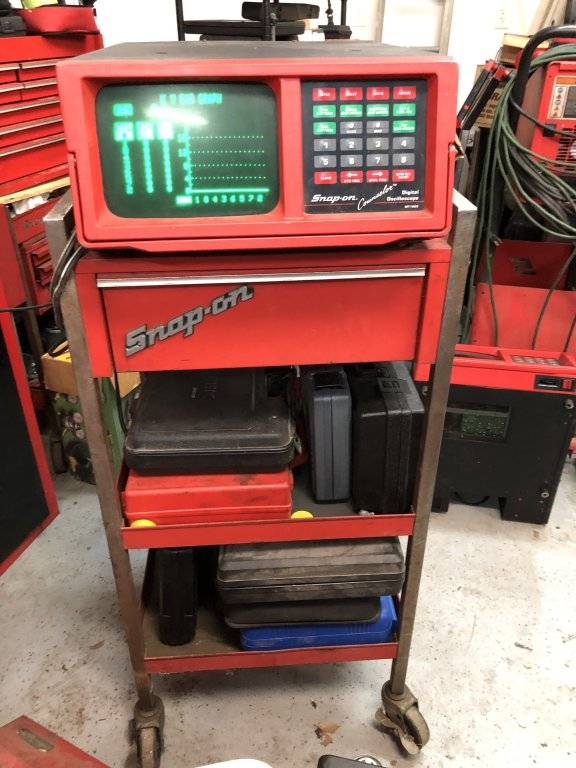

I received the cast iron Tflite overhaul book from Fatsco and going to buy the one way sprag assembly tool . I wish I hadn’t sold my foot operated clutch pack press when I was a Snap On dealer. Almost Everything I sold thinking I wouldn’t need it anymore , I’ve bought back but fortunately for Pennies on the dollar what I paid originally . I finally found a Snap on air operated choke checker with no moving parts inside just a Venturi . It blows hot air out one end and ice cold air out the other . We used to use them to freeze or heat the choke coil on carburetors . Now I use it to cool off on hot days and heat or chill sensors quickly. Found a complete Snap on counselor 1 scope for $150 I use on the older vehicle ignition systems . I paid $3k for one new in the 80’s with all accessories . Bought a couple of sliding upper control arm tools I’d sold , for $20 each on EBay to easily adjust alignment on an old Lincoln . Not selling any old tools again . I loaned a guy a full set of no longer made on car transmission rear tailshaft bushing remover and installers that does that job and a new rear seal in 15 min with the driveshaft out . He wanted to buy them told him I’ll loan them anytime but no sale . I want a Sun distributor machine I used as a teen frequently setting up single and dual point distributors just because it’s relaxing to use and cool to watch flash .
