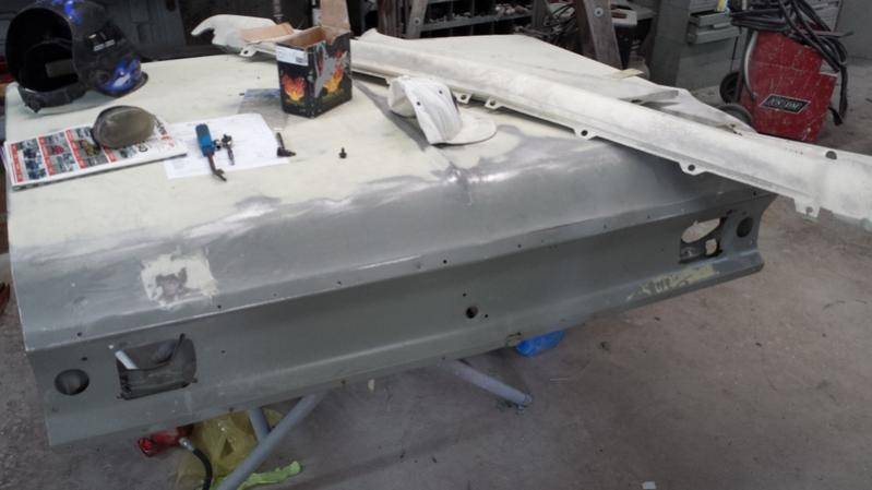

You've got an issue with your deck lid. Your trunk is for a Fury 1 or 2. Not a 3 or Sport. See the attached picture of 3 or Sport deck lid. So you have a few choices. You can try to find a different deck lid. Good Luck, I do think there is one on eBay for $500. You'll then need the rest of the trim, panel and tail lights. The trim pieces for around the tail lights are tough to find. As well as I've seen very few that aren't beat to hell. Or you can change fill in the holes for the trim around the tail lights and make it look like the rear end of a 1 or 2.

Oh I know the decklids off of a Fury 1, no biggie, mig in the trim holes, drill new holes for the trim and tail/reverse light. Not as much work as replacing the quarter on the right side. That decklid has zero rust. I picked it and the quarters and rear bumper up off of a 66 4 door car in Atlanta. That car was like a museum piece. It was so clean, even the bumper nuts were still unrusty. A young guy up there smashed the front, I got lucky finding such a nice parts car.

Are you going to do the deck lid mods yourself? If not find out how much the place doing the work will charge. As it may by cheaper to buy another deck lid. You'll also need to fill holes on the quarters and drill new holes for your trim. Unless you are just taking the lower quarters.
