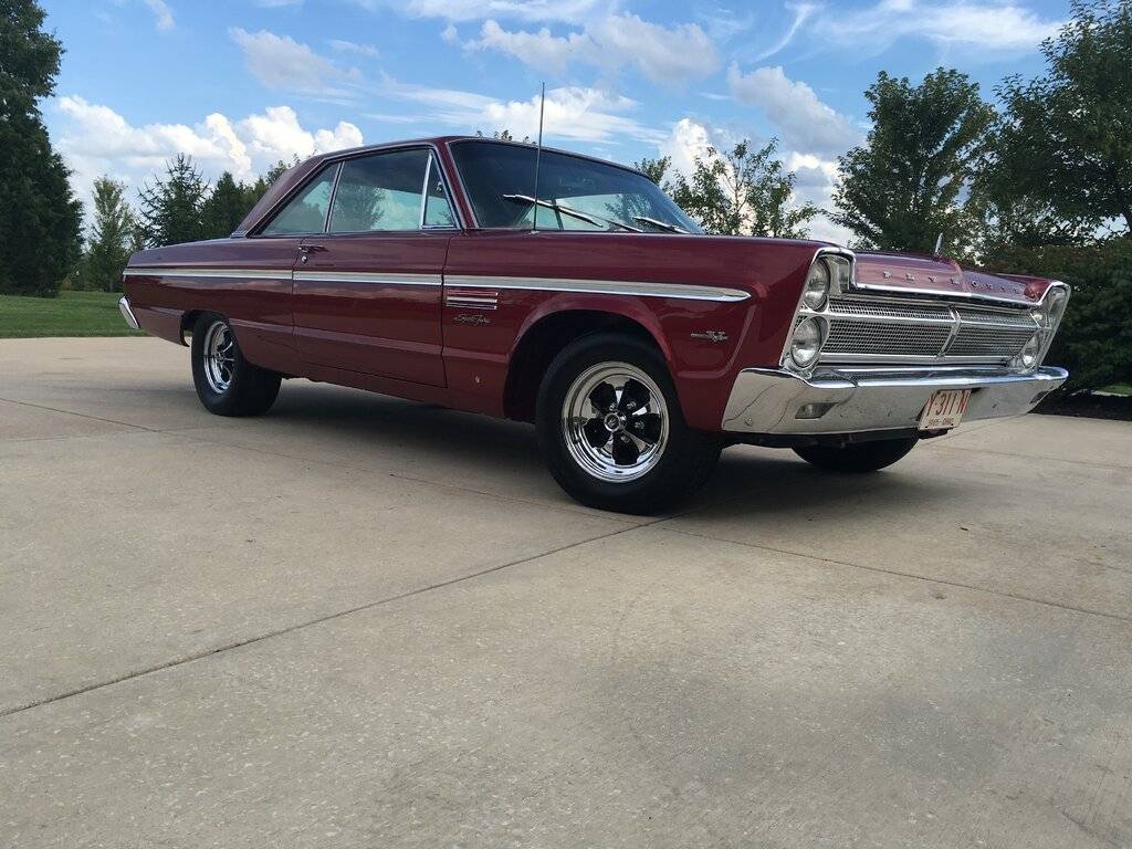

Hi, I did 235/60/15. Speedo is off a little 2 MPH. tires don't rub on front or back but I wouldn't go much wider. Tires are Cooper Cobras, wheels are Torq Thrust. Put them on 3 1/2 years ago, $800 total rims and tires. $100 each tire, $100 each rim.
275/60-15 with no issues on the rear
