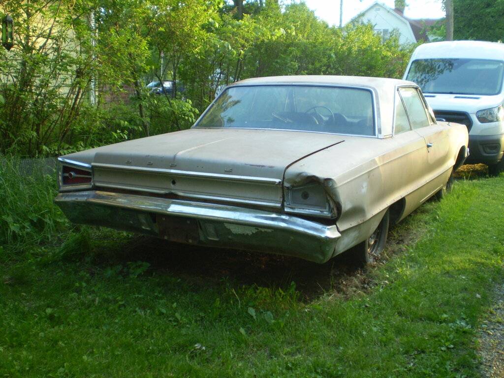

Here's what I'm calling my donor car. I got it from Arizona but not sure how it may have found its way there. I bought this for the rear quarter panels and the other parts that came with. She's got a few "whiskey dents" is what the guy told me. Passenger side tail light is pushed in and distorted the quarter but could be hammered out and I really only need the wheel opening area. The door is caved in. Driver side: front fender near the headlight, other than thay the drivers side is pretty solid and straight. No drivetrain, he pulled a 440 and 727 out of it before I bought the body.
View attachment 380130 Here's what I'm calling my donor car. I got it from Arizona but not sure how it may have found its way there. I bought this for the rear quarter panels and the other parts that came with. She's got a few "whiskey dents" is what the guy told me. Passenger side tail light is pushed in and distorted the quarter but could be hammered out and I really only need the wheel opening area. The door is caved in. Driver side: front fender near the headlight, other than thay the drivers side is pretty solid and straight. No drivetrain, he pulled a 440 and 727 out of it before I bought the body. View attachment 380130 View attachment 380131
Good acquisition. Looks saveable!

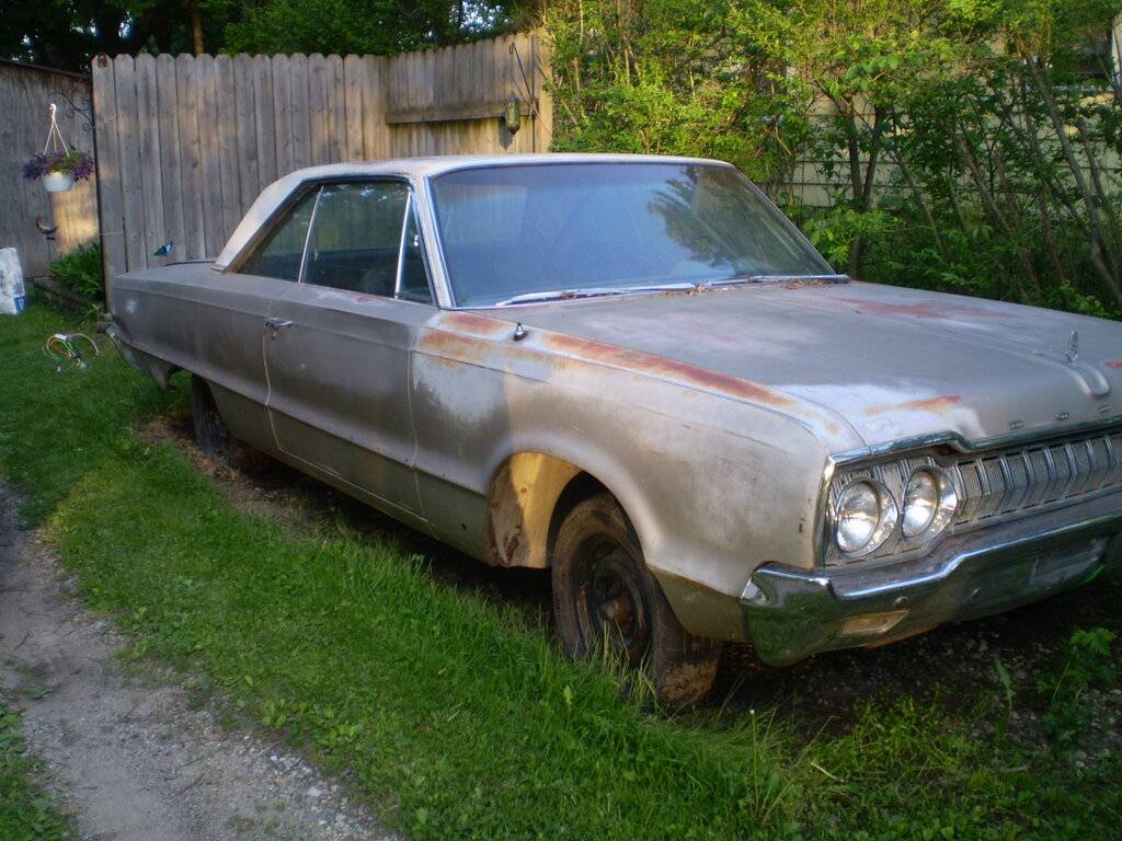

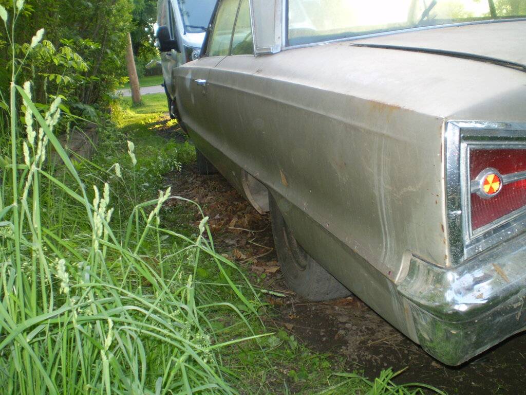

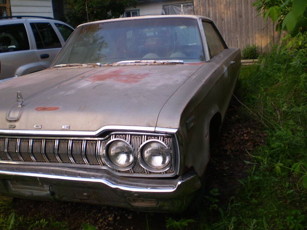

I'll get some pics up of the other polara that's been sitting in my garage...sitting and sitting.
Its pretty solid except the rear wheel openings, having said that I haven't been under the car I a long time and hoping not to find rusted. The plan has always been to restore / restomod it but no source for rear sheet metal and I didn't want to rivet patch and bondo it...(I need to work on my sarcasm) So I found the white top donor car here with solid metal. Now all kinds of ideas going thru my mind.
