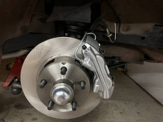

View attachment 391759 Hoping to wrap up brakes tomorrow and possibly fire it up for the first time since I’ve had it.

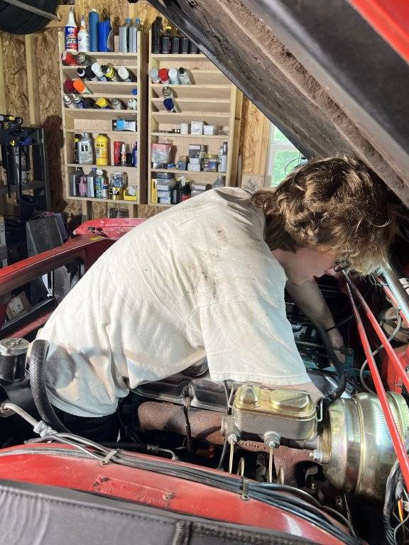

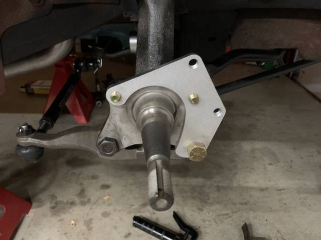

Sorry I missed this post. I bought the LEED kit from PST complete with a master cylinder. It was supposed to fit the stock 14" wheels, but a part of the brake caliper crossover tube rubbed lightly against the wheel. It could have probably been bent to not rub, but I needed new tires anyhow, so I went ahead and got new 15" wheels and tires. I didn't like the way the kit mounted the booster away from the firewall (it pushed up against the oil dipstick and didn't look right to me), so I ended up mounting it closer to the stock location with some slight tweaks to the mounting holes.
If I did it again I would try and wait to source a 1973 disk brake setup. In the end, the brakes work well and I really don't have any complaints about stopping power.
