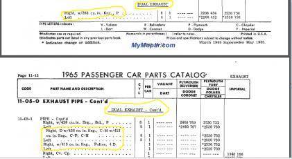

That's interesting that you could get dual exhaust on a Fury with a 383, but not on a Polara with a 383. According to the parts book the only
Polaras with dual exhaust are the 413 police, and the 426 cars. I wonder why they would have done that. :thinker:
That's what I thought too, but according to the parts book they didn't. This is for the head pipes section. I didn't see any dual exhaust parts listed for a '65 Polara (D) with a 383 4-bbl. I don't know if you can make this bigger so that you can read it.

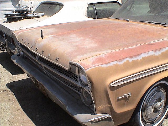

When I was a kid, we had a '66 Fury with the 383-2bbl. It had the Commando V8 fender badges (the same ones as are on my 383-4bbl car). The '65 383 (any variant) should be a Commando too. If the '65 that goodtoothdoc is looking at has fender badges, they would probably look like the photo below (much better looking than the '66 badges in my humble opinion):
