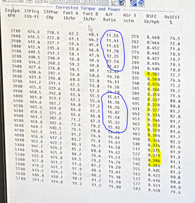

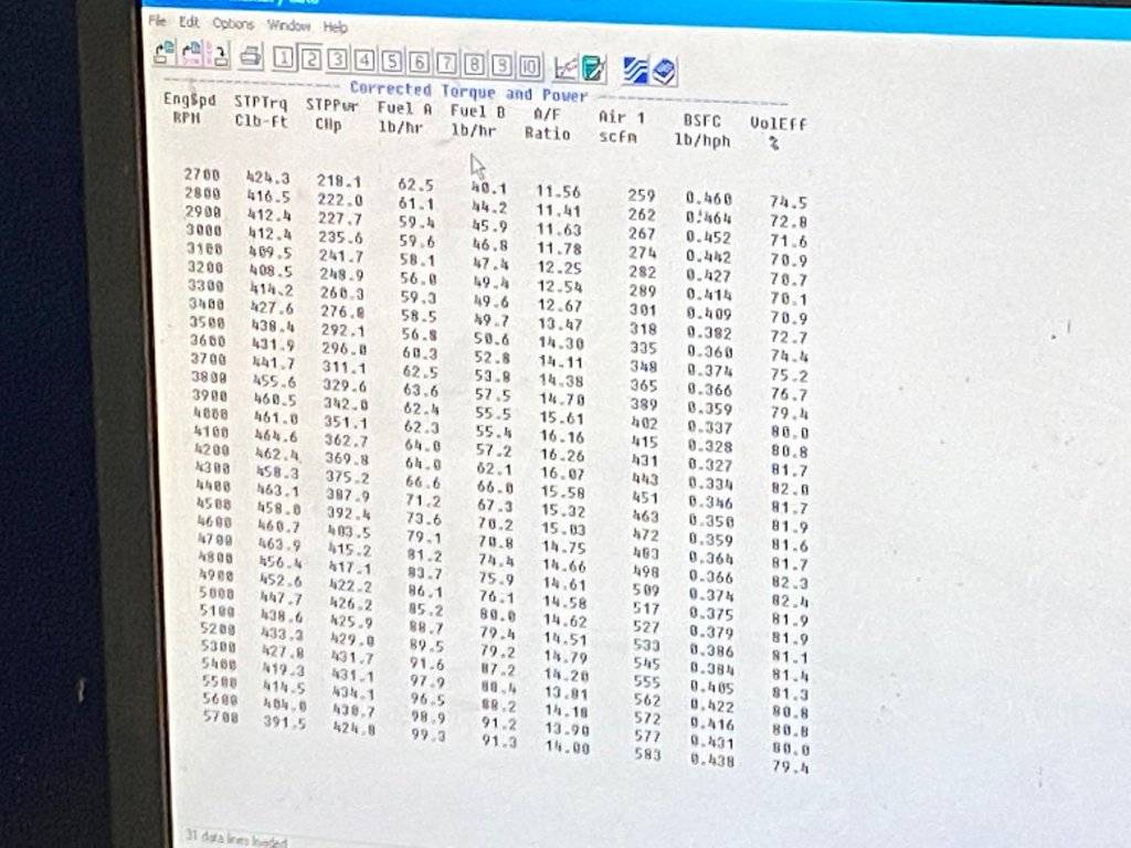

No, it was Dyno'ed, I was there when it was done. The project began from scratch from a raw block (1970 cast 383). 440 Source Stroker kit (aluminum "Stealth" heads)...Hughes BB cam (nothing too crazy, just what they consider be their street, but with a little growl)....the car is going to have a complete TTI exhaust, 1 7/8 headers to tips. I just need to be sure that the car doesn't twist into a pretzel if I take 50 mph turns (which there are a lot of where I drive).
Screenshot of dyno

I'm not a dyno-chart expert by any stretch, but I noticed your BSFC was in the high .3 area (.45-.55 is the range I see published a lot) and then noticed the AF is rich on the lower end, and has a lean spot around 4000-4500 rpm (where you have the torque peak). The lean area would not be unheard of for an engine at part-throttle cruise, but not what I would expect to see running at FT. Again, not an expert.
*320
Did they dyno the engine as-is or do a lot of tuning to maximize it?
*320
Now you are beginning to speak in an area for which I am out of my depth on. (Again, I was the "apprentice", not the master builder). But because I was there, I can tell you that it was dyno'd as is, but using the racing shop's carb and headers, (not mine). But other than that, nothing at all was tuned or done to the engine other than hooking it up to the machine. Not to sound like an idiot (but admittedly, there is still so much I need to learn)...I know what the A/F ratio is, but I do not know what the BFSC is. Is the phenomenon you describe a good thing, or a bad thing here? I do know that when we were done, the shop owners and the master builder all agreed that they were very pleased with how the engine tested, and we were happy as hell that we built a project engine from scratch that worked and it did not blow up when we tested it.
Ah, using the dyno carb explains most of it. Shop headers are often used for hook-up convenience, but a carb could go either way (shop or customer). Sometimes you'll see/hear of jetting changes happening between dyno pulls, or even carb swap or other changes. But that takes time, so it costs $$ also. So the shop carb got thrown on and jetted in the ballpark.
BSFC is a fuel usage parameter (calculated) based on amount of fuel used to make horsepower. Lower numbers mean less fuel used, .45-.55 is a range that is commonly published for automotive gasoline engines, with .45 being naturally-aspirated and .55 toward forced-induction engines. The BSFC goes down as the AF ratio goes up. This is happening in the middle of the range, where the torque peak is, where an engine is making the most torque per fuel used, so I would anticipate could be leaner there. But being that lean (AF of 15+) at full-throttle seems like some power was left on the table?
Presumably there was some joking going on there - I'd never want a Master Builder to be happy as hell his engine didn't blow up durign testing!
Ha, yes, some joking going on there, yes...we kept joking about those Dyno Disaster videos, so that's where that came from...I personally was nervous as hell during the test, because it was the first build I've ever been a part of....thanks for the BSFC explanation! I do remember the shop guy choosing a certain carb (off of his shelf of at least a dozen) for the test...can't remember which it was. (My application will be an out-of-the-box Holley 750 cfm). So if understand you correctly, (and if I get my carb dialed in and mixtures correct), I could anticipate a tick or two up in power? That wouldn't be terrible.
Cannot make guarantees, but yes, would expect some more power in lean areas - but that's only 3900-4500rpm.
I would focus on leaning it a bit from 2700-3000, too - you'll spend more time in that range.
But that's only possible if you get a wideband AF gauge and try to hold some steady-state conditions while you're driving.
