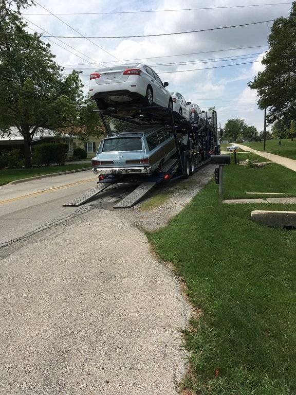

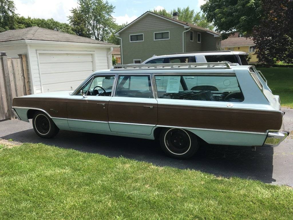

Hey folks,
I'm new here, and new to my Monaco, which just arrived today. There are 2 electrical issues I see right off -
