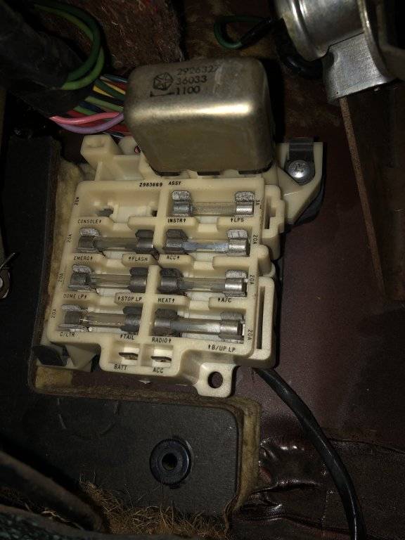

The issue is that the right turn signal when applied seems to light up the parking light side of the circuit and doesn’t flash. I cleaned up the sockets and installed new 1157 bulbs which didn’t help. The parking lights all work as they should. Also,the brake lights do not work but, that is probably unrelated. Or is it? I haven’t investigated it further than changing the bulbs. Any thoughts? Am I missing something obvious? Thanks in advance.

I suspect the brake light switch for those lights since the fuse is good. But didn’t know if the two issues could be related even though they do power the same light.
