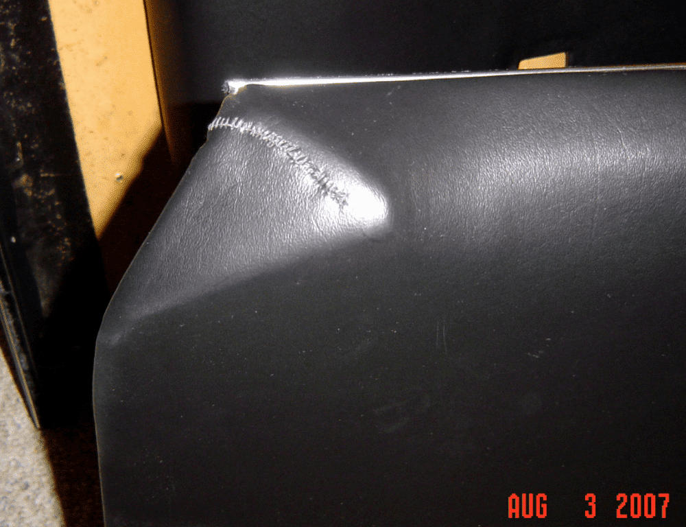

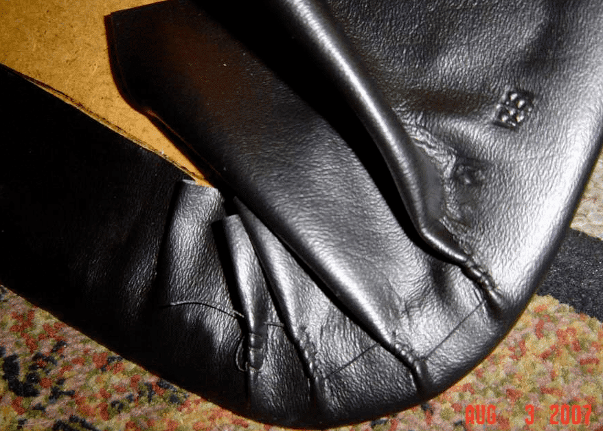

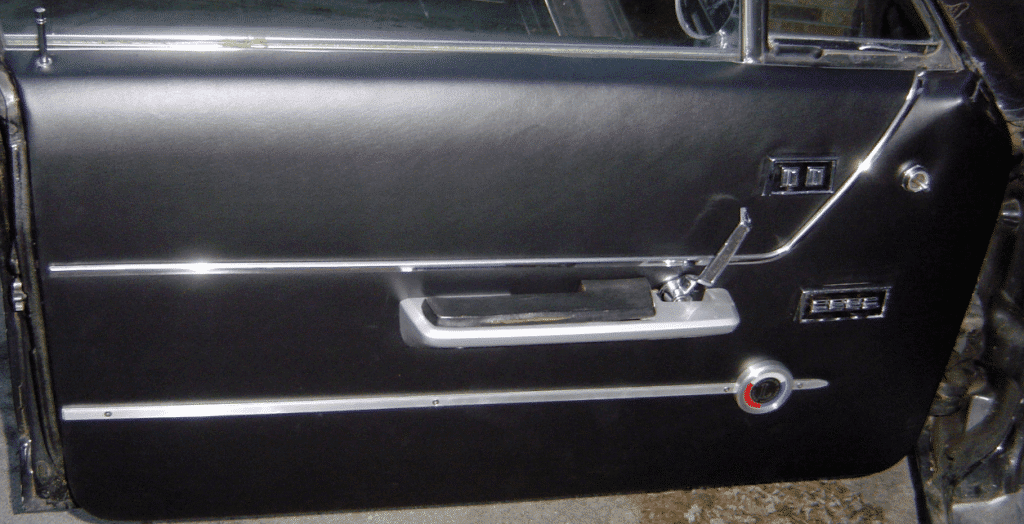

I recovered the ones for my 300L. It was time-consuming but inexpensive, at least. Vinyl from JoAnn Fabric with fleece for underpadding. It your hardboards are in good shape you've got a shot.
Lots of contact cement and plastic alligator clips to hold it while it dried, I did a little stiching around the corners for durability, and had to do some funky stitching at the bumped area at the front. Overall a huge PITA, and not correct styling for a 65 300, but they look much better and no screwholes around the door edge.
The upper chrome pieces came from a 66 Nupe I had years ago, BTW.
Wow you did a great job! I got a complete set of 67 300 panels from burgmopar. They are in really good shape. Only issue are the rear panels. The rear window openings are longer so the panels are about 8" short. But I have parts to make them work atleast. I know it's going to be a pain in the butt but I have all winter to get them done
