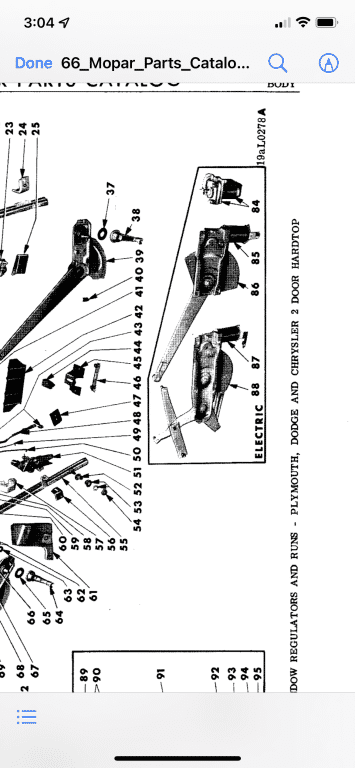

Hey there, does anyone know where a guy can get the electric motors for the window regulators? Would this sort of item be similar throughout the mopar lineup?
Just clean them..
Take 'em apart, clean all the old grease and scum out,, clean the armature and the brushes...
The new grease and put back together..
Take LOTS of pics as you disassemble so you know how goes back together...
They will probably work better than the new r4eplacement types .....
Just clean them..
If the motor runs but the windows don't move, the three round "pucks" in the gearbox have turned to dust. Dorman has replacements. They are tricky to install, best bet is to keep them in the freezer, and heat the gear they go into in boiling water for a bit. Per the above post, clean and grease.
Alos, the same basic motor was used up to the M body Fifth Avenue era, so junkyard finds can work (hint, take the rear door ones, used less). You may need to swap brackets, etc from your old ones but this is a cheap supply source.
