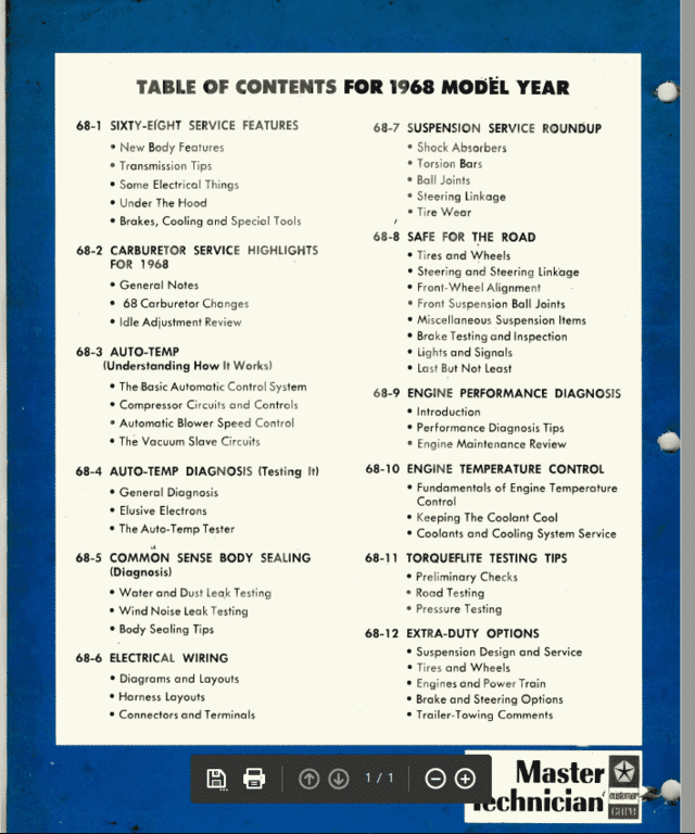

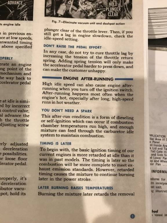

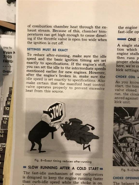

I just read the ‘68 Chrysler “Master Technicians Service Conference on carburetors and Engine Performance Diagnosis. A very good read prior to getting ready to start my car. Dieseling was one of the topics.
To me it seems like it covers many of the topics discussed here with poor running engines.
I bought the CD version on line about 8-10 years ago? 1968 master technician. Not sure if they are still around, but this is where I ordered it from. Table of contents below as well.
