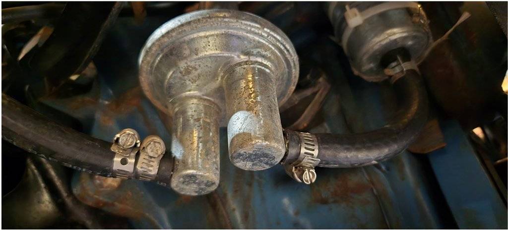

Just curious... 5/16" fuel hose? That line from the tank looks like it's squeezed down like when someone has a 3/8" hose on a 5/16" fitting. But it's a picture and hard to tell, so I may be just seeing things.

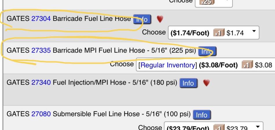

You're seeing things just as I see them there. Either that's a 3/8" hose going into that pump or a badly swollen 5/16" one. I advise our O.P. to get new, good quality rubber, not AutoZone's generic stuff. Gates Green Stripe was mentioned as a good standard.... I should check up on this, as some of my aged fuel line rubber will need replacement w/n the year.
