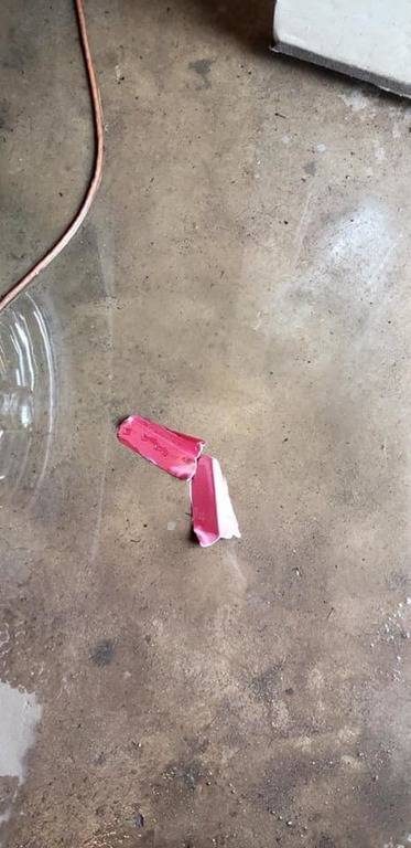

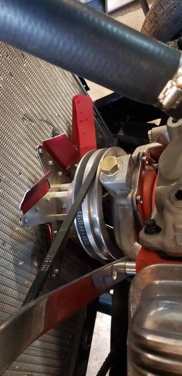

Having seen a brand new flex fan explode and go through a steel hood, I always advise against them. If that wasn't enough to convince me, another incident where a local guy was killed while timing his car by an exploding flex fan made sure.
If the car has A/C and the 26" wide radiator, find a stock shroud and use the stock fan with a new clutch.
Just happened to see this today on the book of faces.
55901942_2768420856531332_4215340689686265856_n.jpg?_nc_cat=1&_nc_ht=scontent-ort2-2.jpg
55793544_2768420886531329_4995565500944613376_n.jpg?_nc_cat=1&_nc_ht=scontent-ort2-2.jpg
