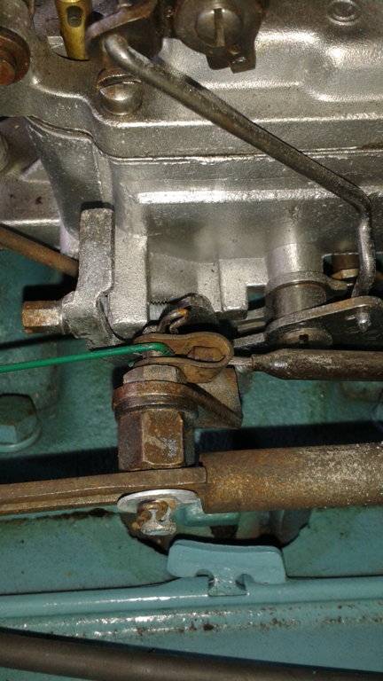

    I don't think my throttle cables/springs are set up correctly, previous owner has messed around with a lot of things on this car so...can someone post some pictures of the throttle linkage and return springs, especially the kick down rod and spring.

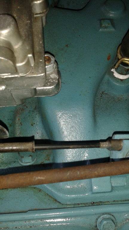

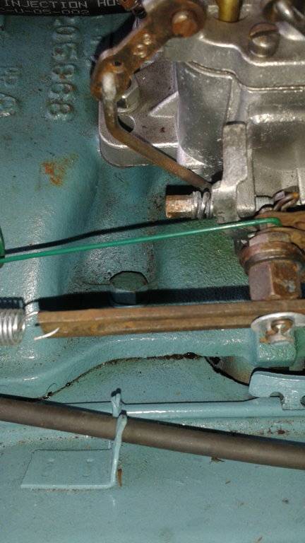

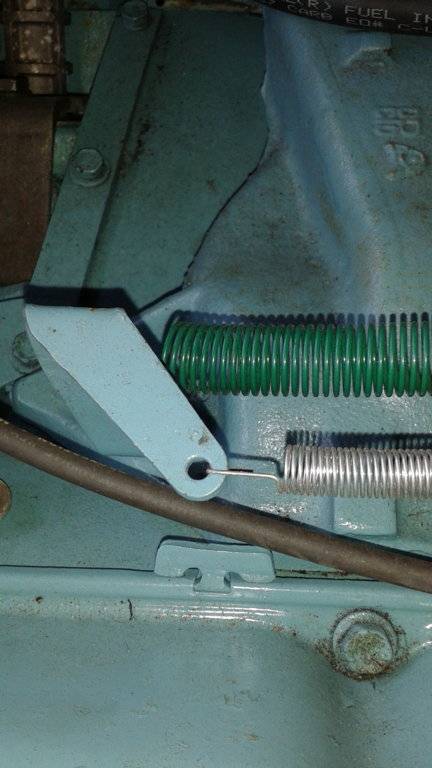

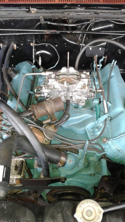

    1966 300 (10).jpg 1966 300 (11).jpg 1966 300 (12).jpg 1966 300 (13).jpg 1966 300 (14).jpg
    Hope this helps, 1966 Chrysler 300, 383 4bbl. No A/C.

    1967 Imperial used a Holley carb...
    However the linkage pics Trainwreck posted still shows how it is suppose to be....

  9. 413
    413 Active Member
    Messages:
    294
    Likes Received:
    98
    Joined:
    Jan 28, 2019
    Location:
    NW USA

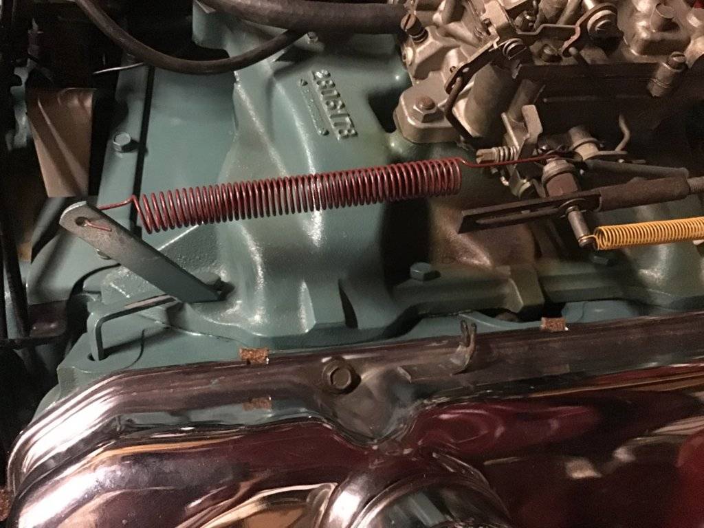

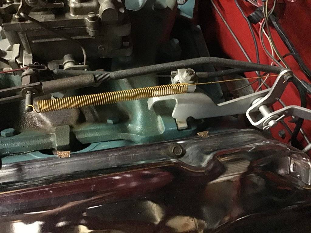

    The pictures of the 1966 are different. The spring on the kickdown won’t run forward, it will go rearward on the 67.
    The stud that everything mount to is longer.
    The return spring bracket at front intake bolt is different, just goes up, not bent over at the top, only the carb return spring runs forward on the 67.
    These photos are a 1967 440

    Thanks guys, I should have noted that mine is a 440 with no A/C.
    The pictures posted should help me though.
