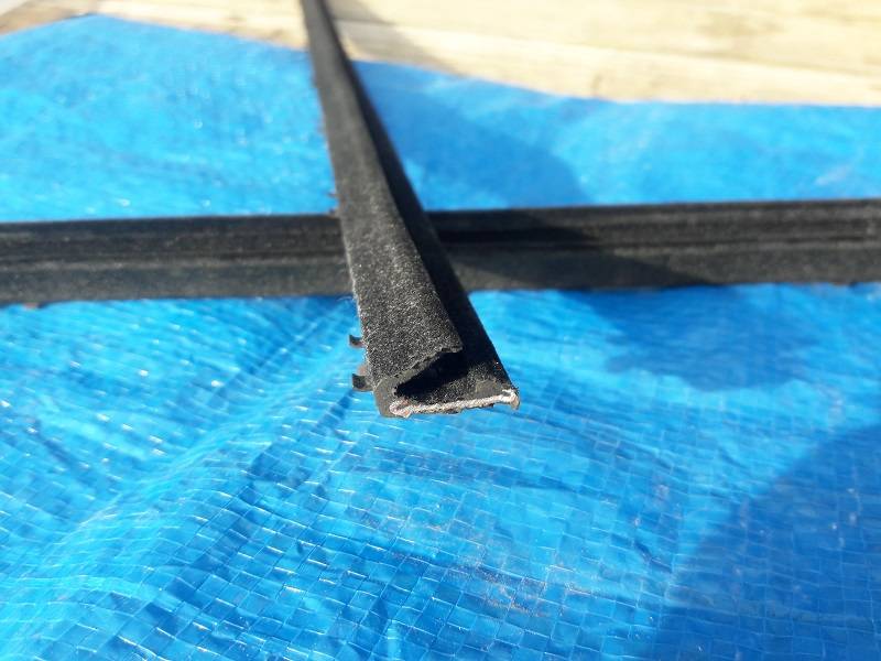

No, this part (circled in red). Specifically the very top edge (bead). Same applies to outer piece also.

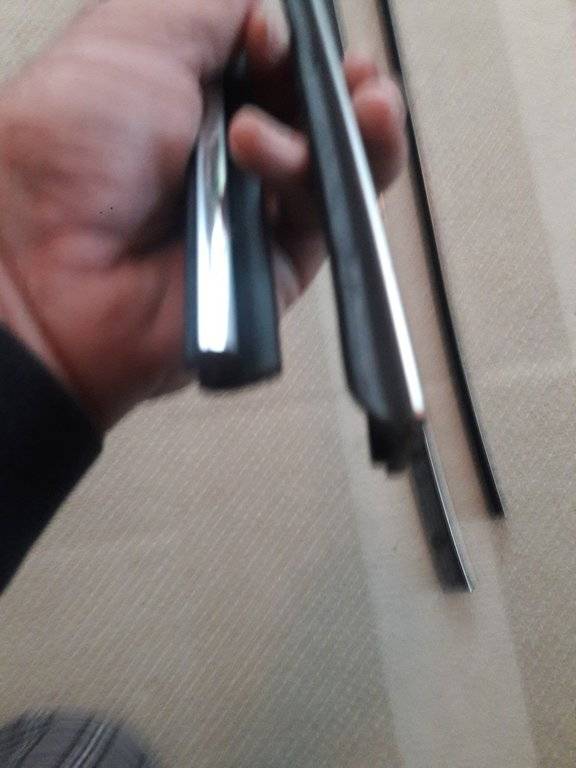

@Polara_500 is correct that the belt strip in this style is the base style with just a cloth material over the metal frame with the flocked rib. The intermediate level is basically a similar material with a round bright bead that lies next to the top of the door frame. The flat bead style is a much wider piece of material that actually sits on top of the door panel and is much more decorative.
I have attached two pictures that may give you a better ideal. The first picture shows the wide flat bead on the left. The intermediate round bead is on the right. The second picture is more the style in which you pictured of the base style. These pictures are not the actual felts for a 65 to 68 C-Body, but hopefully helps to you understand the differences in which we offer the different styles.
