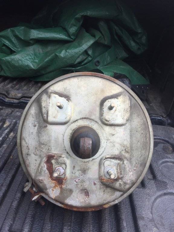

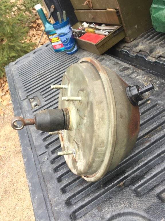

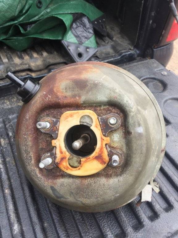

So here is the original brake booster from my 67 Monaco. I am sending it out to John Stewart’s today. Quoted me about 250 and reasonably quick turnaround time. Plus shipping of course. I have a feeling this is the best thing to do.

So I sent up the vacuum brake booster to John Stewart’s in Canada. He quickly rebuilt it and is sending it back today. I’m keeping my fingers crossed, they have been great to work with so far.
