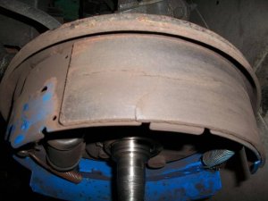

I am doing a complete over haul on my brakes, new master cylinder, shoes,wheel cylinders, spring hardware etc, i am having trouble finding front shoes, the only ones i could find are 3" wide but in the owners manual it says only police cars and the High performance 440 version were fitted with 3" wide shoes.
I took the wheel off and couldnt get the drum off easily so had a bit of a measure and the drum is about 3.5" wide would this be a 3" shoe? and the manual also says my car should have 6" wide wheels the standard ones on mine are 7"
