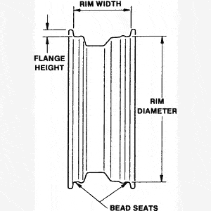

Wheel measurement is from bead surface to bead surface for diameter and width, not the overall width or diameter.
The overall measurements on a 14" x 6" wheel will be about 15" x 7"
Backspace and offset will be measured to the outside edges.

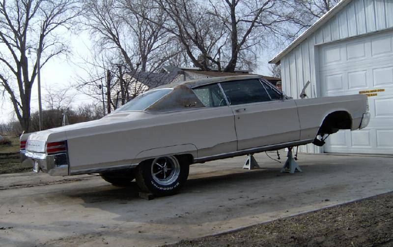

Let's see some pictures of your car...
