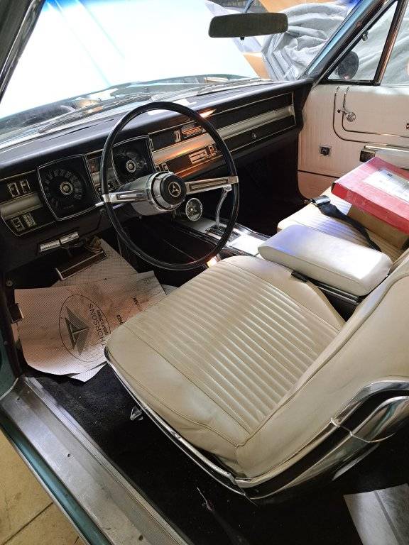

Just wondering if anyone knows if any of the aftermarket steering columns work on a 68 300. My car is a floor shift, so I know finding the correct one is a long shot...

Do any of you c body gurus know how long the steering column is for a 68 300? Just trying to see what aftermarket ones might work if I can't find an original.
