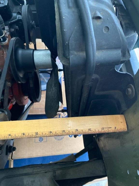

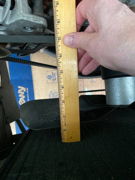

It looks like you have a pretty think spacer under that fan. To get more clearance, the easiest thing would be a thinner spacer.

I concur that the path of least resistance would be a shorter fan spacer. They are available aftermarket in many thicknesses.

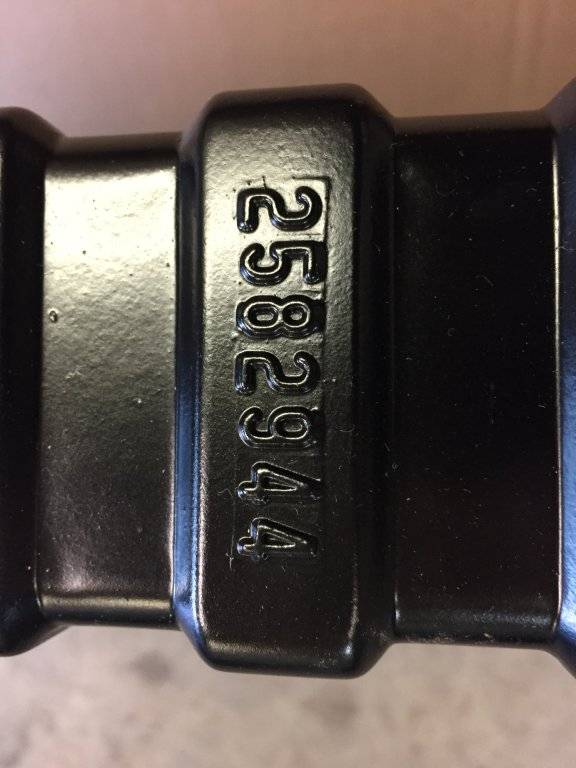

So it appears that I somehow have a B-body rad (2898038) which adds to the Google-confusion for me. Am I reading this correctly from the service manual that automatic 318's without a/c did not come with shrouds? It's definitely no taxi.
That’s correct but a B & C body radiator shroud should fit the radiator that you have. I added one to my ‘68 Fury with a 22” radiator.
Do you happen to have a part number for that by chance?
