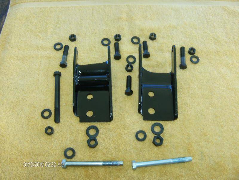

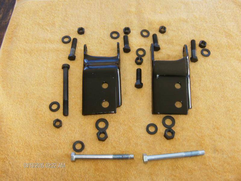

The oil pan hits the stub frame on the front. I did change the motor mounts to these
I took them off the 383 motor that came out of 68 Coronet Wagon.
The oil pan looks like this (not sure on the stamped number though)
Please advise if I am using the right mounts / pan.

The most common correct pan for the big block c body 66-68 is the 187 pan. I'am not familiar with the formal oil pan setup. The 68 coronet b body big block mounts are correct.

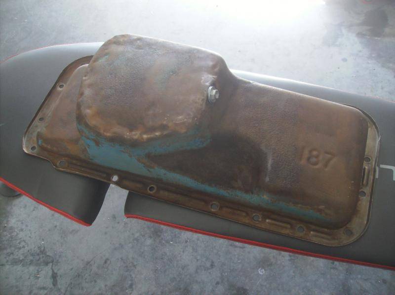

Yes there's a stamp on it that says 187. It's a 66-68 big block c body specific pan with the notch for the idler, and the right drop to clear the stub frame.

Last night I dropped the motor in with oil pan removed - everything lined up fine. So I need a correct oil pan. Anyone has the 187 / 669 pan for sale cheap? Otherwise I will just trim/weld the pan I have. I did some measurements and it looks like the idler arm might clear the pan without the notch.
Also, the pan has a baffle welded in. Do I need it with windage tray? And what if I use both?
Leave baffle, use both anything to keep pick up covered with oil, unless you drive like a putz.
Cut and weld, stock pan does not have baffle, why go backwards.
I decided to save myself $150 and use the oil pan I have. I trimmed it by 1/2" on the front and and it cleared the frame fine. Now when the wheels are turned all the way to the right, the idler arm is touching the pan a bit. I will have to either make a notch on hydraulic press or cut/weld. I will take care of this tonight and will post pictures.
