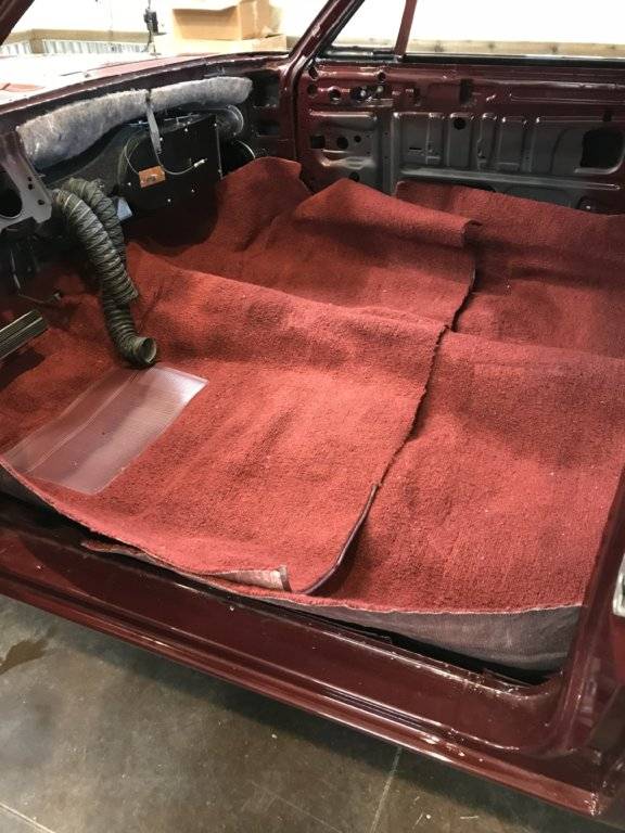

Maybe a little premature, but pulled the new carpet out of the attic. I ordered it in July of 2007.
I need to let it rest awhile after being rolled up for more than 10 years.

If you have any questions don't hesitate to ask. This one took about 8 hours or so taking my time and by myself. (I also had to make a store run) Not sure if having help would have sped up the process or not. A hand here or there couldn't hurt, but spring clamps and long arms help. Slow and steady, no glue or trimming until you are sure. I think the next time (at least in the next 2 years) if I had to do another, I could probably do it in 1/2 the time.
Have on hand: Heavy strength spray adhesive for the insulation, Brush on Contact Cement or Headliner glue (I hate the over-spray potential, but masking is an option) You really only want the glue on the outside edges.

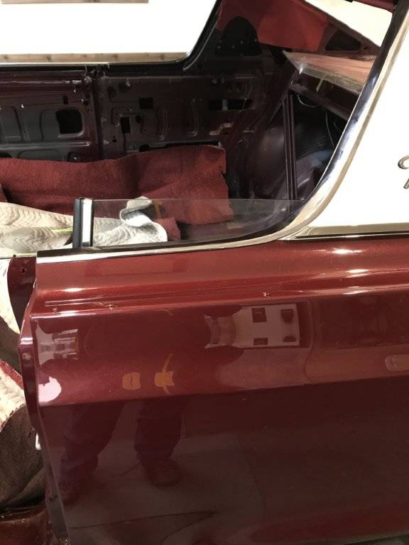

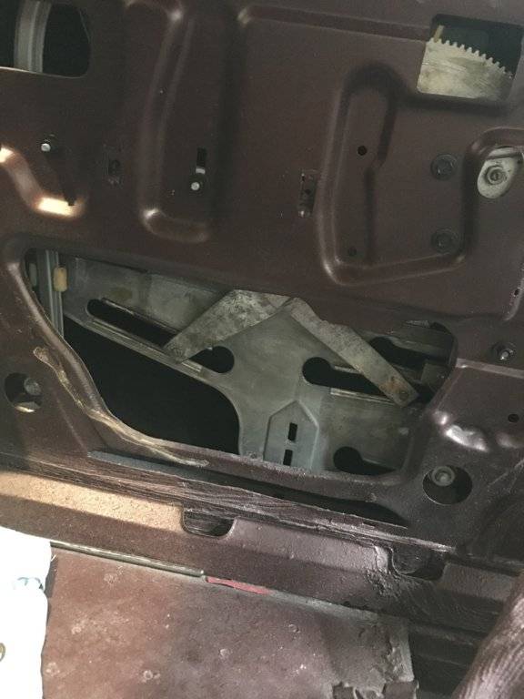

Putting in my rear qtr window. I haven’t decided if it is a spectacular engineering feat or just a contraption.
The service manual says just put it in and line up the rollers. Easier said than done. Now that I have it in, I am trying to put the spring nuts on the roller stem. I need to figure out a tool and small clamp to get that damn spring but seated. I think I have had enough fun for today.

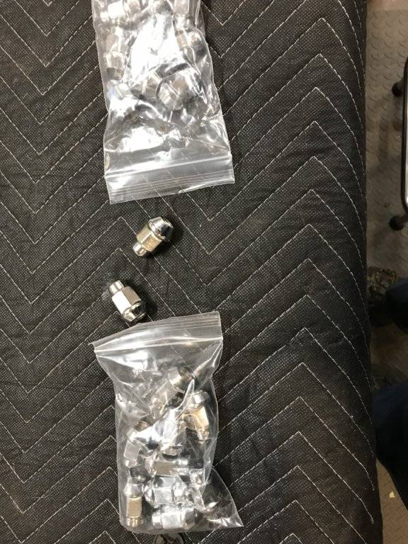

Just in case I get some Magnum 500 road wheels for Christmas, I have the lug nuts. Right and left. I suppose I should look into center caps next.

Watch it fall into place when you come back to it. Happened to me more than once.
I think I have a set of center caps...... may be repro tho.
Well my wheels would probably be reproduced as well.
Or I could just get a chrome dust cap and put the shiny lug nuts on my steel wheels.:D

My thought is that the rear quarters are installed before the headliner. The top of the quarter window rubs on the headliner to lift it high enough to get it in the channel.
The other qtr window tip I have is to put the rollers on the front channel. Set the front channel into its holes to hold it out of the way until the window is in the cavity. Get the window in, rotate it forward to get the rear slider on the guide rail. Bring the window down and then remove the front rail from its holes and install the rollers in in the channel. Reinstall the front rail and the rest is much easier.
