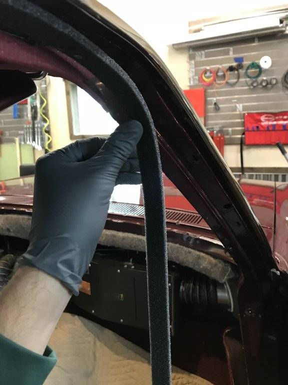

Roof rail seals in. Now just have to adjust the windows and possibly the roof rail. Seems there is no less than 10 things you can adjust to get it right, meaning adjustments are a crap shoot.
Key is not to glue the seal until everything is adjusted.

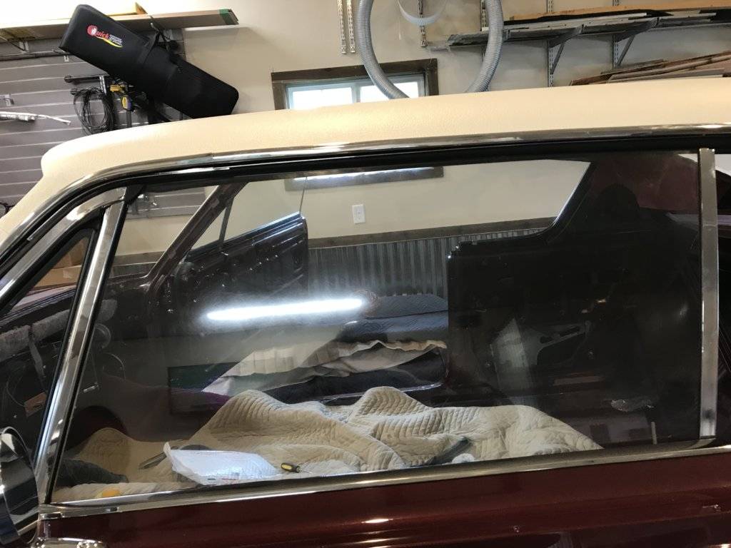

Front windows close on drivers and passenger side.
Have in and out set about right. I need to lift the rear of the window about 1/16”. On the passenger side I got lucky and only needed minimal tweaking. I ended up setting the FSM in the car and explicitly followed the directions. That helped with what to adjust first and to better understand the system as a whole.
Now for the back qtr windows.

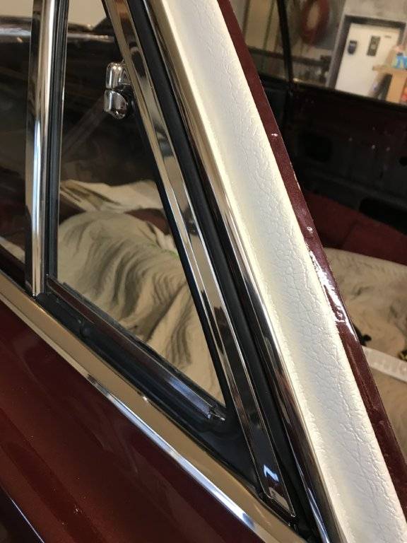

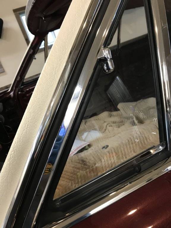

The way the front window seal sits concerns me. Should it be tucked in to form a bulb when the door is closed like at the top of the picture, or overlap like at the bottom. Any pictures of a ‘67 or ‘68 2dr ht in this area would be appreciated.

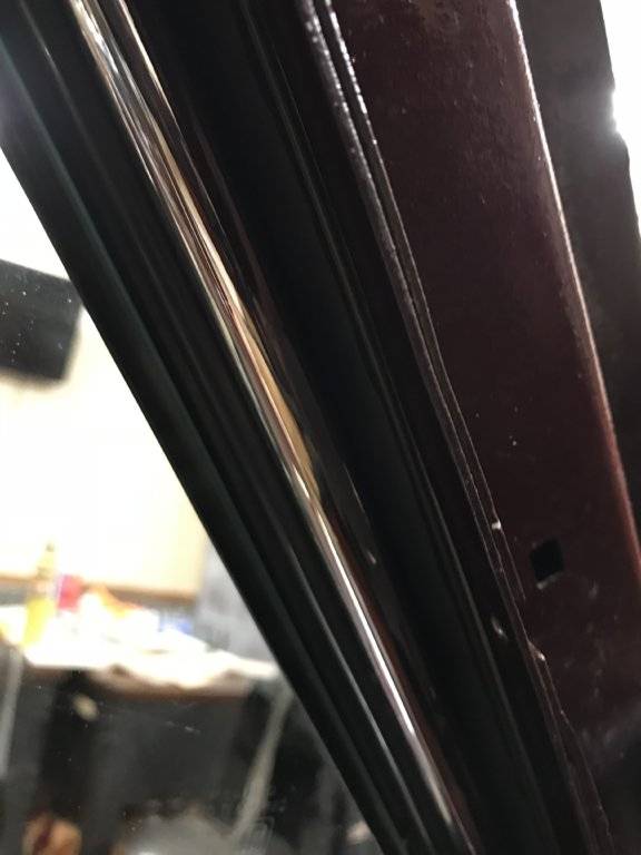

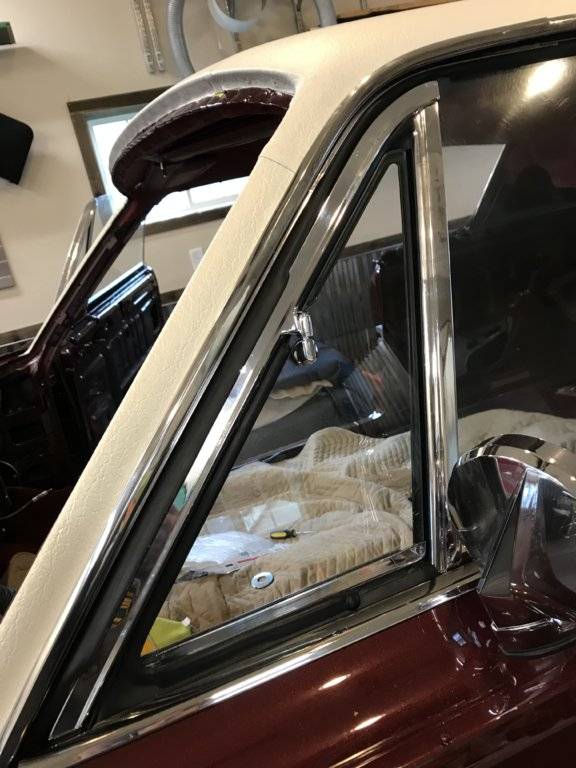

I did a little more adjusting on the roof rail on the A pillar. The weather strip is in training. Hopefully it takes a little set. This looks right.

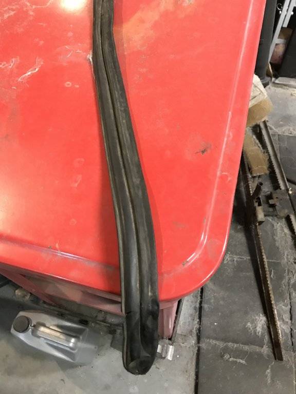

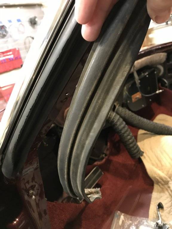

I think that your the weatherstrips have possibly been installed left to right (left side on the right side and vice versa)... there should not be that much rubber visible as I see in your photos. I think the fatter part of the extrusion should be on the inside edge pehaps?
They can only go in the channel one way, so they are not backwards, plus the upper sealing surface is correct.
I just checked my old. The difference is the outer portion is not folded over as much on the new compared with the original. Which actually should help sealing. I think after a little training it will take a little bit of a set and fold in properly. Even after just a few hours it is starting to settle in.
Interesting - I restored a 66 and used new R.R. weatherstrips and I don't remember there ever being that much rubber visible... and the gap between my vent window frame and the window pillar seemed much narrower in my memory...
Any chance your doors or the vent window assemblys need to move forward within the door itself?
They really can’t slide forward as the one pivot is pretty much fixed up and down and fore/aft. The main adjustment is the front pivot which allows it to angle forward or backward to level the front window. Also the windows seem to be where they are supposed to go. Too much further forward and the rear qtr would be too far forward. Plus the inside of the door hits the seal about right.
Found one of the windows before I took them out. It looks to be about the same gap.

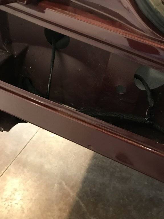

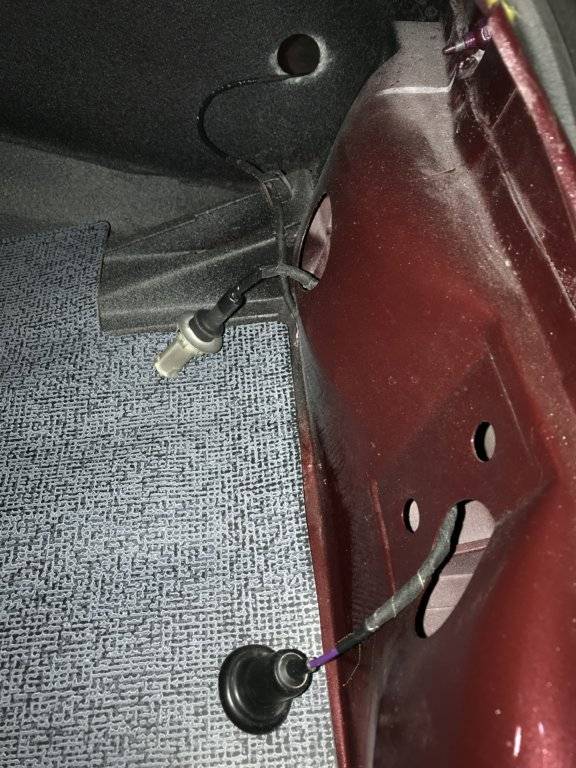

I have been working on my trunk harness routing. I was concerned that I was missing my little metal straps in the trunk on the light panel. It turns out ‘68 Dodges are different from Plymouth and Chrysler and also different from ‘67. I think I have it resolved now. Harness is routed inside the filler panel so no clips. If anyone has additional pictures of a ‘68 Polara trunk harness paste it in the thread below.
'67 -'68 Polara, Monaco,500, Show me your rear (trunk wire harness)

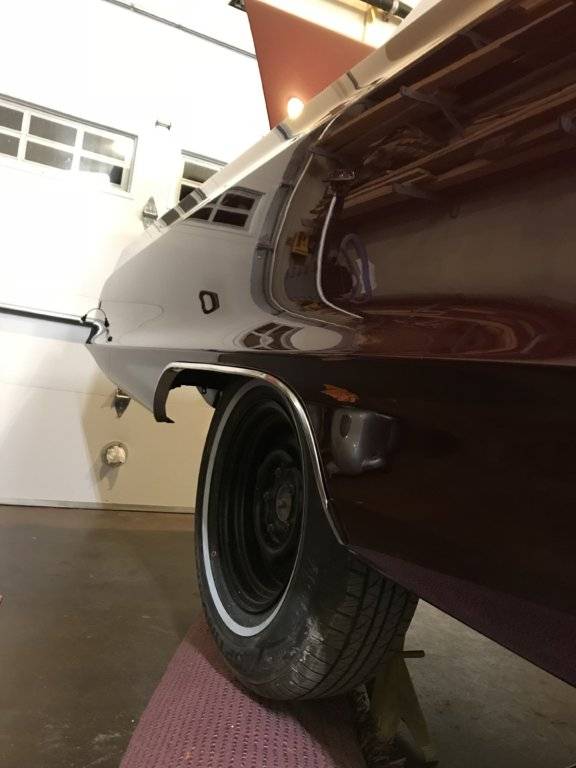

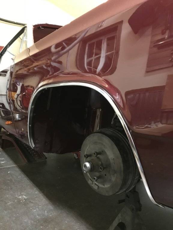

I decided to pull my right side wheel well trim out of the attic. I got one piece in 2009 and another in 2010. Both NOS. I am still looking for left side. I did get the right side installed.
A little clean up with the buffer and they look new.
