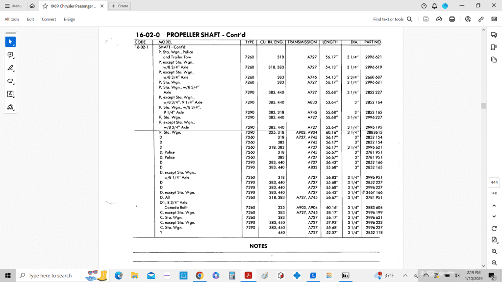

I have a 69 300 and need a driveline for it. I found one out of a 68 imperial but it has a CV style (doble u joints on end) guessing that is imperial only?? thanks
That is Imperial only.

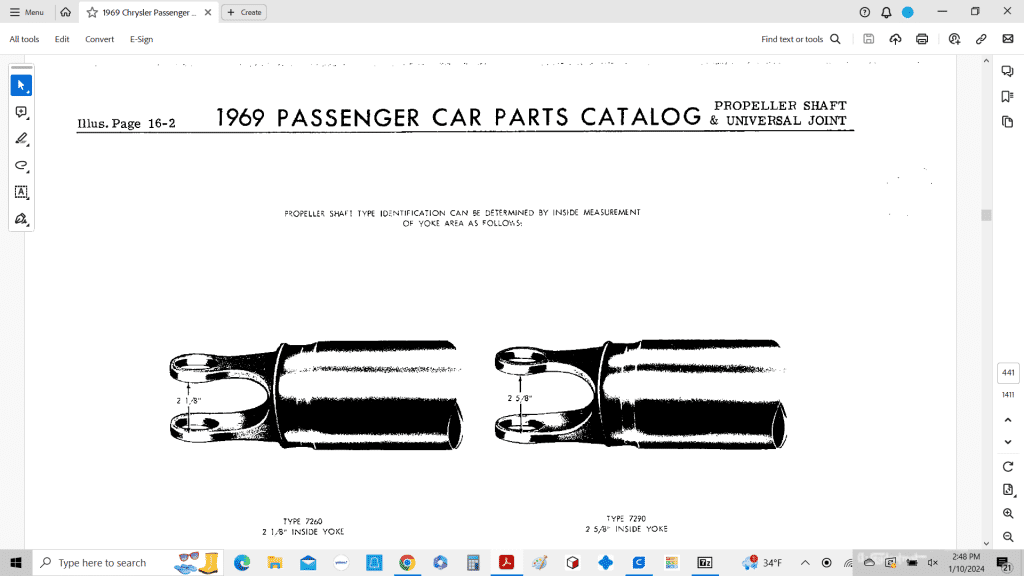

Best to either find the correct used one or it may be cheaper to have a new one built. Here's the length from the parts manual, measured center of the u-joint hole to center of the u-joint hole.
