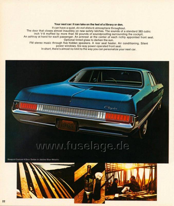

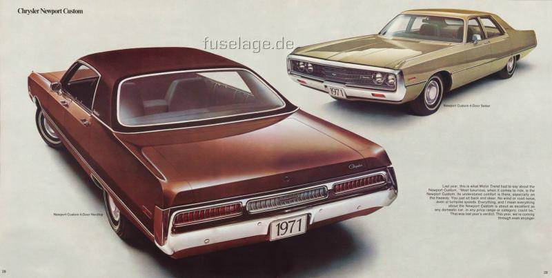

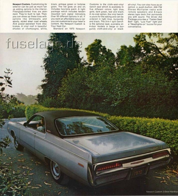

External differences in Newports & Newport Customs from 69-71 are confined mostly to slight trim variations and the rear end styling/ bumper. Note that in all years 69-71 a Newport Custom taillights are different from the base Newport by the addition of a finned bezel (Customs in pics below). The 69 had a one year only rear style and the 70/ 71 rear style are just tweaks to the same bumper where a scalloped centre piece was added on the 71s. Body panels are interchangeable.
