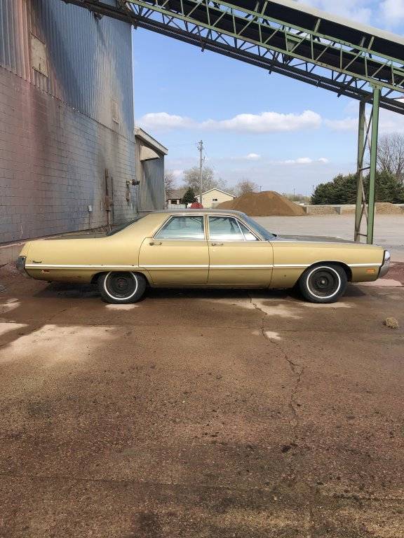

I recently bought a 69 Newport. It has power drum brakes currently. I read an article that said any 69 and up Chrysler disc brake setup will work for the drum to disc swap. I have been doing some research when I can. Just making this post to see what the best options are.
What is the “go to” year and model to get what I need for the swap?
Will my booster work?
I know I need the different spindles, proportioning valve, dust shields, calipers, rotors, master cylinder. Anything else? I know I can get the master cylinder rotors and calipers at the parts stores. Just want the calipers for the core charge.
